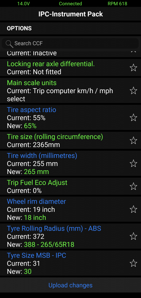

@Jimmy Brooks - I have the exact same config and used your settings - thanks. Curious, what do you run your tire pressure at? Assuming it is not the LR4 standards, also wondering if they can be changed in the TPMS.

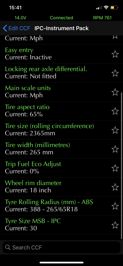

Here they are. My tire size is 265/65/18 so if your tire size is different this most likely won’t be accurate with your real speed.
Reviving this...
Is the "Tyre size - MSB" parameter the ONLY one I should be changing?
Also, you had changed it to 30, but from what? I feel like I'm reading conflicting messages as to whether that number should go up or down as the tire diameter goes up.

Awh nope - size, width, rim size, and MSB - that 30 is an odd one that down is up and up is down. So when I changed mine this show prior to the commit.

Nope - did not touch / change. Just the parameters above. Interestingly many things changed once those settings were updated. Speedometer is dead on but the rolling circumference may impact something other than that.

And GAP tech support said "The value does not reflect a direct measurement.
Menu--Car Config--Instrument Pack--Tyre Size MSB - IPC
Is the correct setting, others don't work"

Yeah I received same somewhat fuzzy response. Anyways, your settings have my Waze speed and digital speed dead on. :driver:
