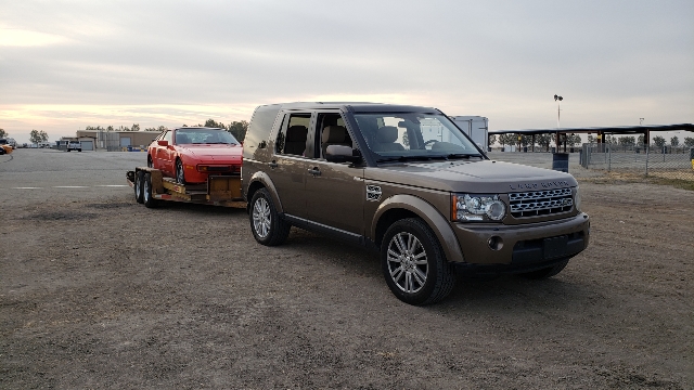

About 5K miles so far. That includes towing, so have not been taking easy.
As far as tools, I have been holding onto them for now. But we can talk later if you don't find something elsewhere. I have rented out the ns300l kit once already, so that would be easy if you want to do that.

Early or late interior 944?
Damn, I loved those cars. I still rate my modded 968 as the best handling P-Car I have ever owned. Whooda think 150-250 HP could be so much fun.
85.5 944 n/a so the late interior. Was just thinking about a turbo the other day, but I daily this one to work 30min each way and it has not left me stranded in 4 years. Not sure if the turbo complexity could do the same. So much fun to drive!
