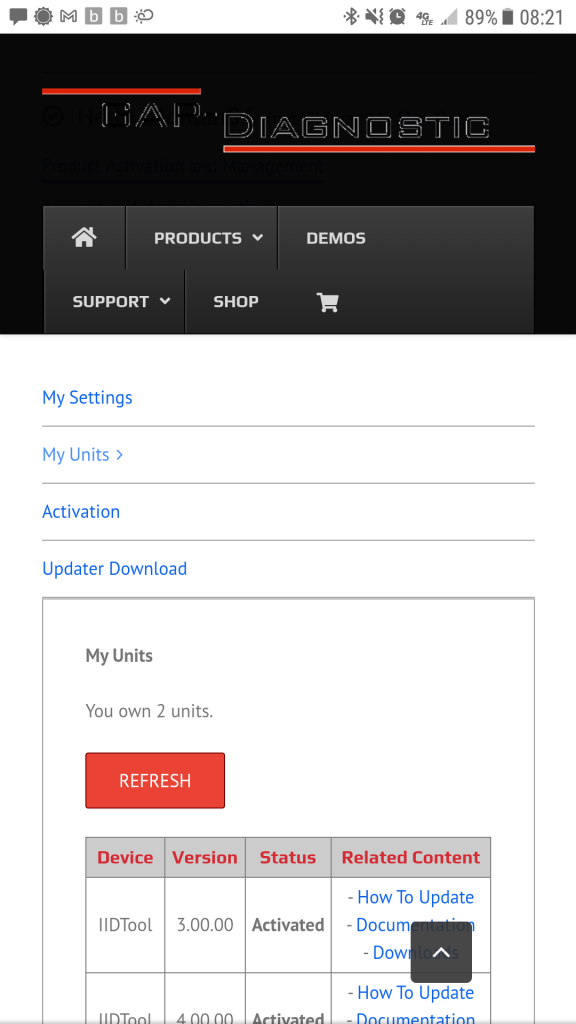

Michael Gain
Dec 8, 2018
612
282
Clarksville, TN
I can’t find anything of that sort on their website.
You're right. You will have to create an account. It's under "my products" (banner on top of account page). Then you will see "updater download" above "my units"
