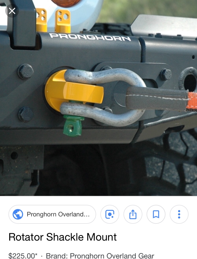

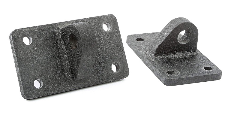

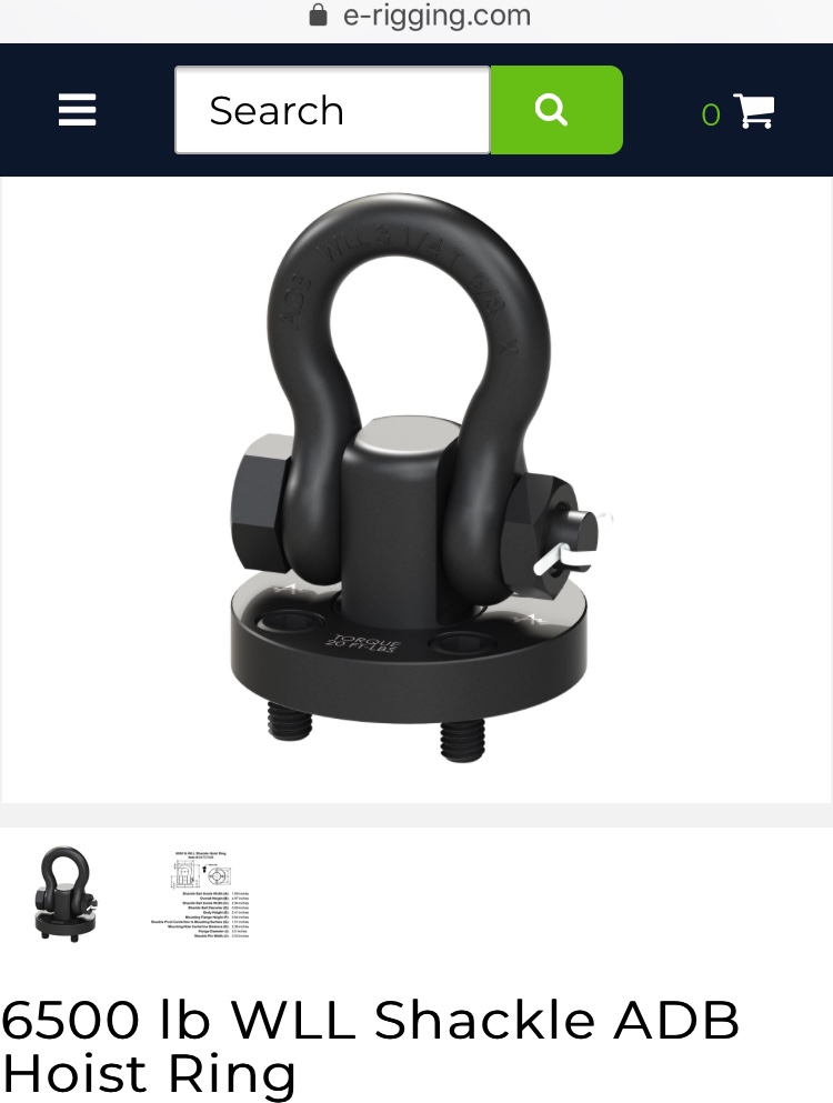

So far, if found and considered these photos. Any other ideas?

Yeah, the more I think about it and measure the bumper, the more I’m leaning toward the third photo option as the rest are just too big to fit anywhere with some structure.
I may just forget about them and carry some extra straps to wrap around the bumper in the event.

A common upgrade is replace the bolts that Tactical Rover's supplies with two "swivel hoists" that then bolt the bumper to the winch tray, but also serve as recovery points.
I don't know the ARB setup, so just throwing that out there in case it helps.
Something along the lines of these are what I am referring to. They are available in a ton of sizes and load ratings.
https://www.carrlane.com/en-us/product/hoist-rings/swivel-hoist-rings/heavy-duty-swivel-hoist-rings

The ARB has winch mout to bumper and bumper to frame. I looked at those, and didn’t think that a single bolt would be enough surface area to be pulling on the ARB skin. Plus, I don’t know enough to find a retaining clip to secure the ring to protect the bumper.
And black oxide surface rusts something awful, so paint or powder coat would be needed.
