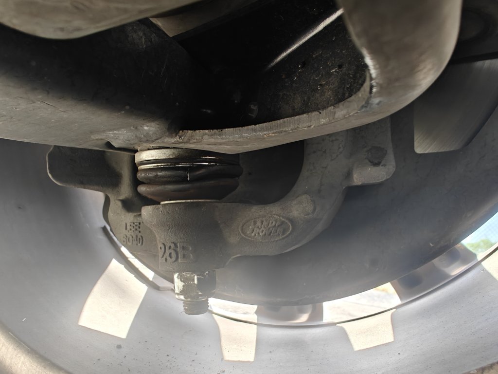

I did a tech inspection the other day on my LR4 and one of my new control arms has a tear in the ball joint boot. The other side boot is fine. I wonder if there was flex in the joint that caused a tear that or if it was left like that during install? It seems like there should be a ring or keeper around it. The boot falls down off the metal mating surface. Any ideas on how a tear could happen?

Weird. Having done that job myself recently, all I can think of is that maybe it was damaged during install. Maybe only mildly at the time, but with time and thermal cycles it got worse?

The retaining ring probably got dislodged during shipping.
When the boot dropped down, it got caught against the ball joint. Tearing it.
Should be a parts warranty repair.
