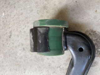

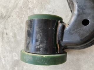

Forgot to reply to this. So i talked to AB and they promptly sent a new set of LCA’s. Had them installed and couldn’t believe what came off. Both LCA’s were cracked at the weld where the large bushing goes opposite of the ball joint.
I’ve never seen anything like this before. So this cost so much having the ball joints replaced twice, axles done because they thought the know was I there. Axle done a second time because the boot had a hole in it.
Just glad it didn’t rip apart further while driving. I did a 2000 mile trip with the family and a fully packed car. Mechanic said it was just a ball joint. All good. Not really I guess.

Are you saying that the cracked LCAs were the first new ones you bought from AB?
I had issues with AB LCAs in the past. I ordered a set and my indy shop said they simply didn't fit. AB was great about the return and replacements. However, the replacements didn't fit either! (yes, the correct item had been ordered). AB also took back and refunded the 2nd set. The shipping on those heavy things must've taken a bite but they covered it all. I finally went with OEM ordered locally.
I have to believe that my situation was an anomaly. I have always equated AB with good quality, and I have no complaints about their customer service especially after that incident.
1,403
Stiff bushing puts too much stress on a poorly welded part? Honestly those broken LCAs look like poor quality (welds) Your vehicle should not handle like that. You need to get a 2nd opinion somewhere.
