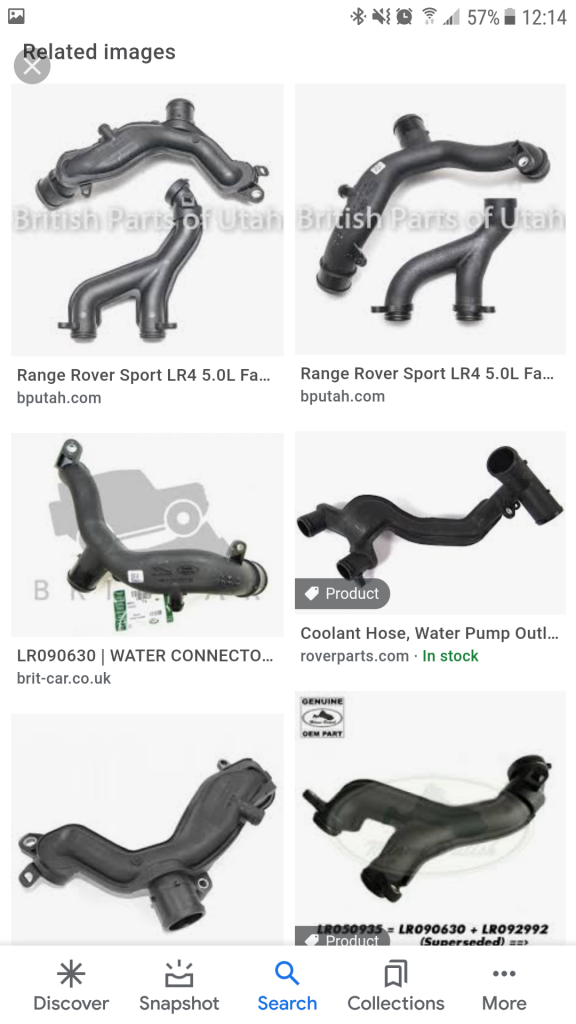

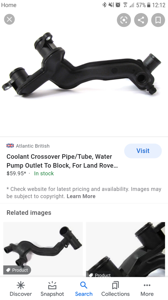

True, and why would that part be different on the two engines...is it different?
Definitely a different part. The early pipes looked like the 5.0 (two halves plastiwelded together). The newer rendition (shared with the newer discovery) looks like an evenly formed pipe--no seams.
Old, 5.0 one piece pipe:
Side-by-side old and new two-piece pipes (top two pictures):
