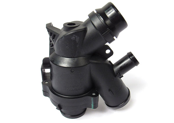

Wait. The thermostat housing is plastic too?
:eek:
Yes!, and with a lot of bends and glued/plastic welded joints, mine had leaked from a joint, I got the part back from the Indi shop but I haven't had a closer look at it yet.
The part is only about 90$ on the web at Roverparts, but when you are stranded, you can't be arguing about prices with the shop doing the work :(.

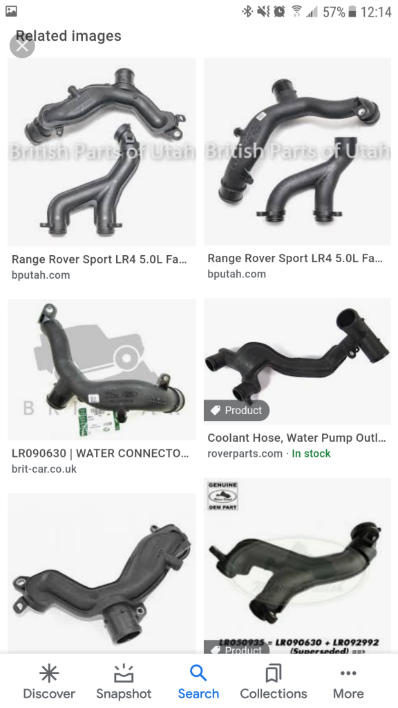

okay. so I've not read on this thread that my year (2015) has poorly designed pipes and doesn't have poorly designed pipes.
Which is it? Should I be thinking replacement or not?
I would say it depends on mileage and what pipes you have.
Like I posted earlier. If your upper crossover pipe looks like the left picture, you should probably upgrade to the right picture before it splits along the seam:

My 2015 just went front and rear with water pump. There is a terms mismatch here, the shop manager said the crossovers don't fail (cough) and she'd only ever seen one fail and it was at nearly 200k. She said the front and rear coolant manifolds do go bad and start developing crack and are plastic. So, have we been having what they call coolant manifolds go bad or is she confused? The many page shop receipt stated it was coolant manifolds and water pump and related stuff.
gsxr
May 8, 2017
811
416
Big Sky Country
Coolant manifolds sounds like the plastic pipes we are discussing above. Same part, different name.
Although I do wonder what "crossovers" she thought you were referring to.
