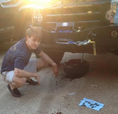

Finally got around to changing the oil on my LR3. It was easy as cake. For me the hardest part was getting the skid plate back on. If your LR3 isn't covered under warranty anymore I highly recommend doing your own oil changes. I ordered cabin, air, oil filters plus oil drain plug for $54 w/ free shipping and used Mobil1 Synthetic 8 qts at $58 from Amazon. One thing to look out for is when unscrewing old oil drain plug, the oil shoots out horizontally for a good 20-30 seconds so be sure to have your oil catch pan about 1'-2' ahead of the drain hole. It took me about an hour to clean spilled oil in the driveway. :biggrin:

Nice looking winch and bumper.
Yes, using the new oil drain plug was wise as the seal is via the rubber O ring and not by over tightening the plug. The oil pan is some sort of cast alloy rather than pressed tin so stripping threads can be costly.
I use nominal 6 ton axle jacks under the frame on the very real chance that the 3 will drop on me while I am under it. 2 ton would be strong enough but perhaps not stable enough. When the air system random vents for no apparent reason, the 3 will drop a couple of inches in about a second.
Disconnecting the battery helps to keep the exhaust valve from opening but axle jacks are for certain.
I was impressed with the look of the front end of your 3 - something to be proud of.

Thanks man. It took me about 45 minutes to do the initial oil change, but another hour to clean up the oil that sprayed out when I unplugged it. I eventually pulled it into the garage to service it, but new I would probably get oil on the ground at some point so I waited before I pulled it in. The bumper is custom made 1/4" steel and still works with the front airbags. I have two D-rings, but only one is installed as I have to bore the other hole out so the pin will fit through.
