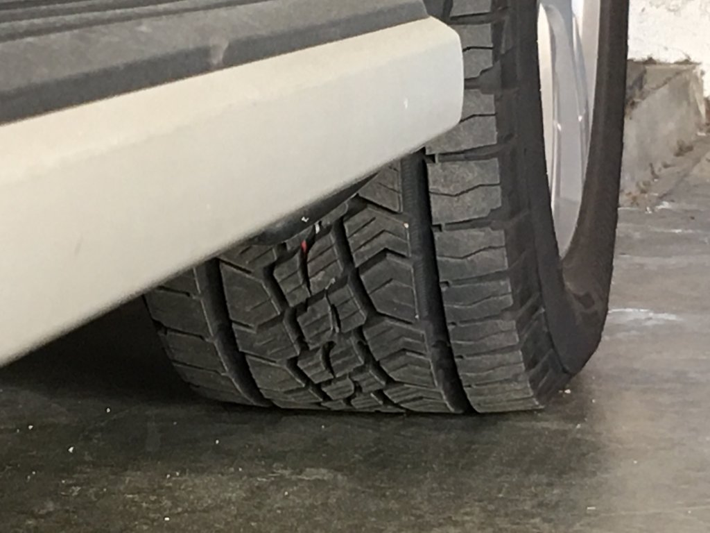

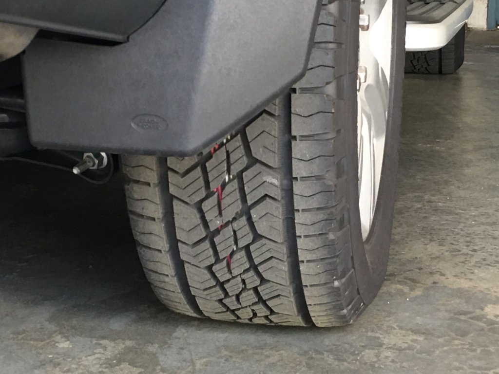

My driveway got coated with some dust last night due to it being windy, and the tread section of the tires picked some up, clearly showing the difference in the width of the contact patch. With 37 up front and 43 in the rears, you could clearly see the difference in the following pics. The tread on the fronts picked up the dust edge to edge but thats not the case on the rears, indicating that the rear contact patch is not really flat:
I mean, shouldn't contact patches be of the same size on all four corners under normal load/driving conditions, specially for a truck with AWD and near 50/50 front to rear weight ratio?
I have noticed the above difference in the width of the contact patches pretty clearly on my stock contis, WRG3, and now the TerrainContacts, all 255/55/19, whenever i got some dust in my driveway area. And I tend to keep a check on the alignment, etc.
I have now been thinking about setting my rears to 40 instead of keeping them at 43 PSI.
But I wonder that when LR made the switch from two separate PSI specs for the rear tires to just one, knowing that this would result into the size of the contact patch of the rear tires being smaller than the fronts, that if they have also made any adjustments to rear suspension and the front to rear torque split and/or the traction monitoring algorithms, etc. in order to accommodate for the difference in the traction/grip levels caused by the difference of 6 PSI between fronts and the rear tires.
I guess only LR engineering can answer that question.
That was a good thought exercise with some solid reasoning. I should probably pay more attention to my tire pressures. At this point I may use that info to intentionally cause premature wear on my Contis. :D
