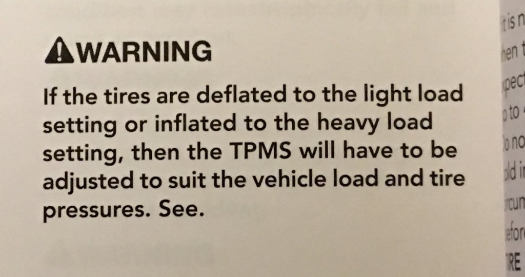

And could it be that the Normal and Full load is now being referred to as the "Light load" and "heavy load" that my MY16 handbook is talking about on its page 240, under a Warning heading:
So tell us Tata/LR, what is that "Light load" setting that you are referring to here? Do you have a recommended PSI number? Or is it that the 43 PSI is your Light load setting? Is it? No? If it is not then what would be your recommended light load setting? And if it is, then what would be your Heavy load setting?
Would your lawyers have the answer, Tata/LR?

I think you may be misunderstanding the statement they make. The way I read that image above is saying if you change your PSI you should reset the TPMS for accurate readings. I do not think they are referring to drivetrain damage.
I dont think that they are referring to drivetrain damage either.
I totally understand why the TPMS would need to be reset, and they are wise to mention that. It sure does need to be reset if you set your rears PSI levels to 39 or 40 PSI vs the 43 PSI listed on the label.
What I am saying here is that there is no mention anywhere about the light load and the heavy load PSI levels. They just give us one value for fronts and rears. But by mentioning of inflating tires to "Light load" and "Heavy load" settings, they are leaving the owners a bit confused. Here is why:
If I am being told to set my PSI to 37 front and 43 rear, are these Light load settings or Heavy load settings?
And I were to guess on my own and assume the front's 37 PSI is High load setting, would the light load setting for the fronts be less than 37 PSI?
And if the 37/43 are Low/High load settings respectively, than during full pay load am I to increase the fronts PSI levels as well?
Now, coming from LR3 and then having owned '13 LR4, I and some of us here could understand that 43 PSI most likely is the High load value. And knowing the LR3' 33 front/36 rear for normal load and the 33 front/42 rear for high load math, we are kinda guessing that even under High/Full load we are not really to mess with the front PSI levels of 37 (36 incase of v8 models I guess) and leave the front value as is.
But when LR does not mention anything about the Normal/Full load anymore and then and the same time also tell us that TPMS may need to be adjusted if we are inflating tires to Normal/Full load settings, they are not only confusing the hell out of the owners, specially the new owners with no prior history with LR3/4, but more importantly they are only and only making sure that they have zero liabilities cuz "we told ya so". Hence the reasoning for this particular para in handbook.
And/or LR is simply making sure that if the informed long time owners are finally able to figure out that this 43 PSI (42 in case of v8) is actually a High/Full load value and if they ever decide to figure out and deflate their rear tires to a Normal/Low load setting, lets just make sure to leave that little paragraph in there reminding them to reset their TPMS so we dont have any liabilities since we are not giving them the correct Normal load value this time around to simplify things for the soccer moms.
