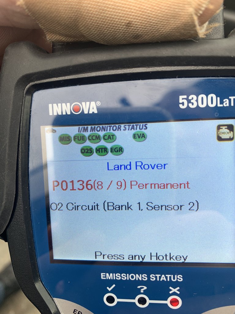

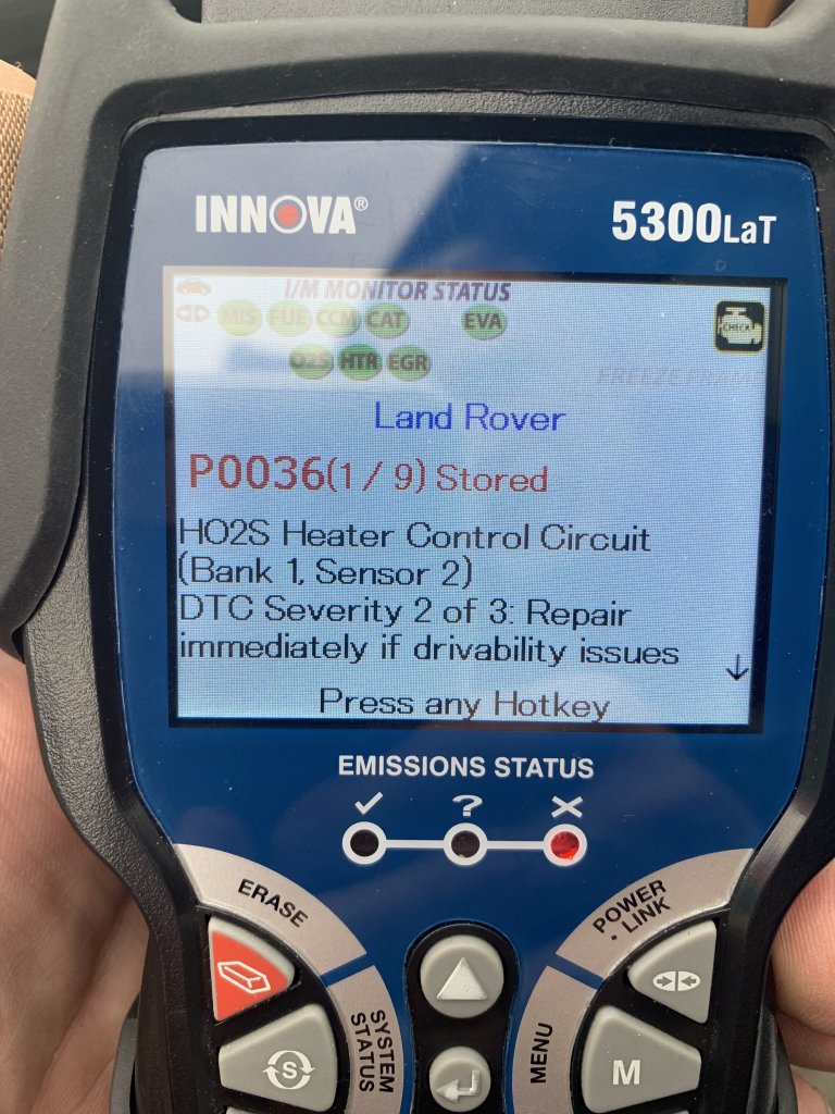

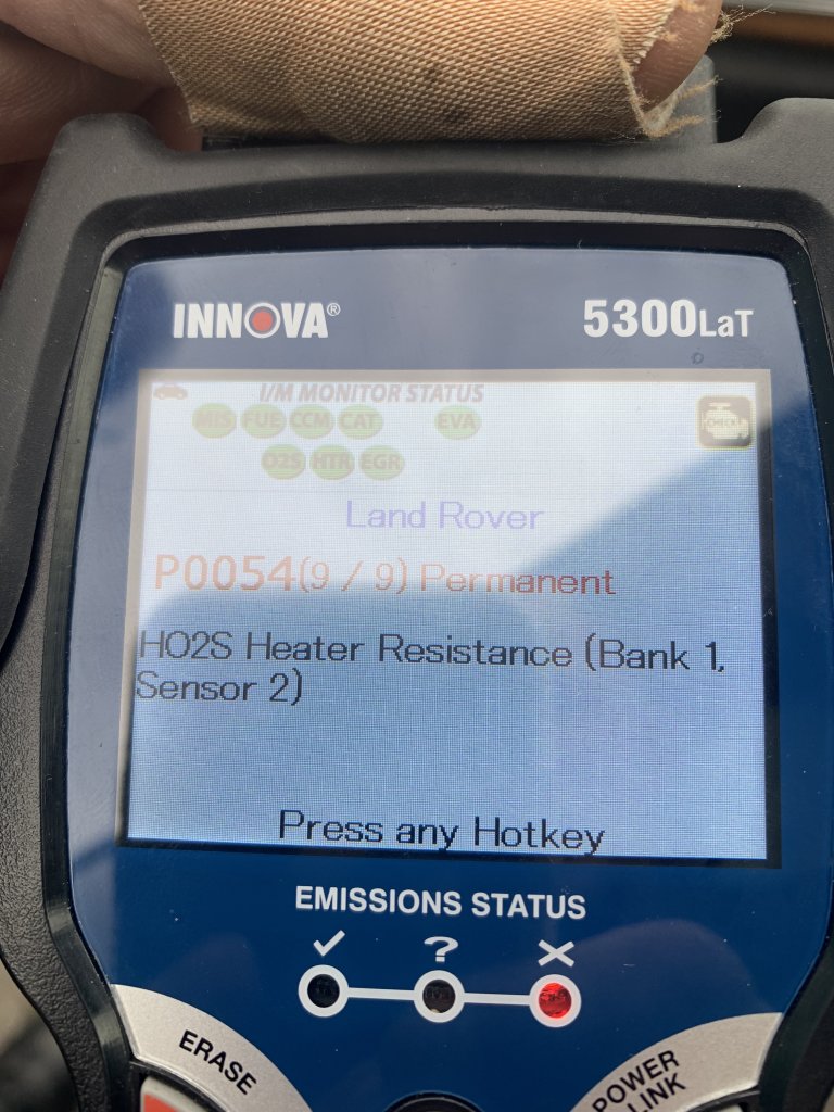

Got the dreaded wife call. CEL light on in the landy. o'reilly's pulled the codes for me. Here are three pics. There are three codes:
1) P0036
2) P0054
3) P0136
Any thoughts on this. Assume it's an o2 sensor?
We have an extended service plan on this, but want to make sure it's covered b4 I run it 45 miles into Tacoma LR dealer.
Thanks

I believe these are just O2 sensor codes and there is a tsb about them. Should be covered under your service plan.
I get one that pops up every 6wks or so for bank 2 sensor 3; no drivability issues and not sure what triggers is, but I clear it and it stays gone for another month or two.

I doubt o’reilly’s cleared them, I know others don’t for ‘liability’ reasons, but I would do that and see if it comes back. May just be a flukey trigger. Any chance it was raining, puddle, or car wash recently? I think the tsb mentioned or I read somewhere where cold water on hot sensors will cause a trigger

No, they did not clear them. No rain and no puddle or car wash according to the boss. It is time for it's LOF and the dealer has agreed to take it in and work it into the schedule somehow. WE are off on spring break so I hope it's done by the time we get back.

I believe this is your mid-catalyst sensor. Pretty easy to get to. If you don’t want to wait for the dealer, you should be able to go to an indy with the extended service plan (I don’t think they require the dealer to do it). Replacing the o2 sensor is pretty straightforward, so any mechanic can handle it - no need for dealer expertise. You could even diy if you were inclined, but I understand the desire to make use of your service contract.
The TSB suggests that water can contact the heating element and cause thermal shock. Since the heating element is inside the pipe, they must be talking about interior condensation (before catalyst is hot enough to evaporate). I don’t see any other way water would get to the hot sensor surface - puddle/car wash would not do it.
