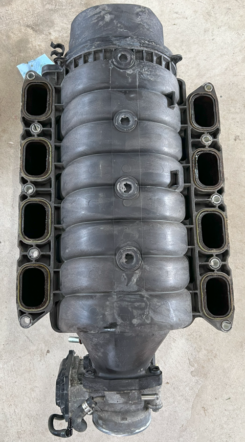

Here's the manifold underside:

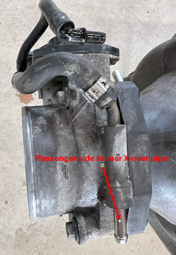

Here's the underside of the throttle body; you need to undo the two pipes to remove the front of the air intake manifold; the passenger side pipe goes under the manifold and connects to the rear crossover pipe:
