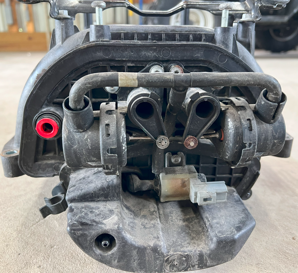

I removed the air intake manifold from my V8 5.0L LR4 today; I didn't find it that easy! Once the ten M6 bolts have been removed the front lifts up reasonably easily; by front I mean the end with the throttle body (assuming everything has been disconnected). The rear end had me baffled as it didn't want to come out that easily... With that in mind there are four things back there that have to be disconnected; I took some photos to help others! So here is the back of the air inlet manifold:

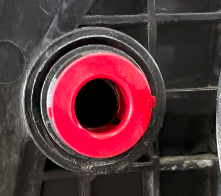

The same pipe vacuum pipe attaches to both the red fitting and the small pipe as indicated with the next photo:

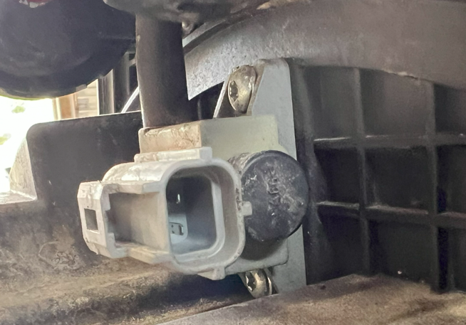

You have a single electrical connection (*** I strongly suggest labeling this as I believe it will be the same type of connection as the one to the rear crossover pipe and could easily be connected incorrectly***):

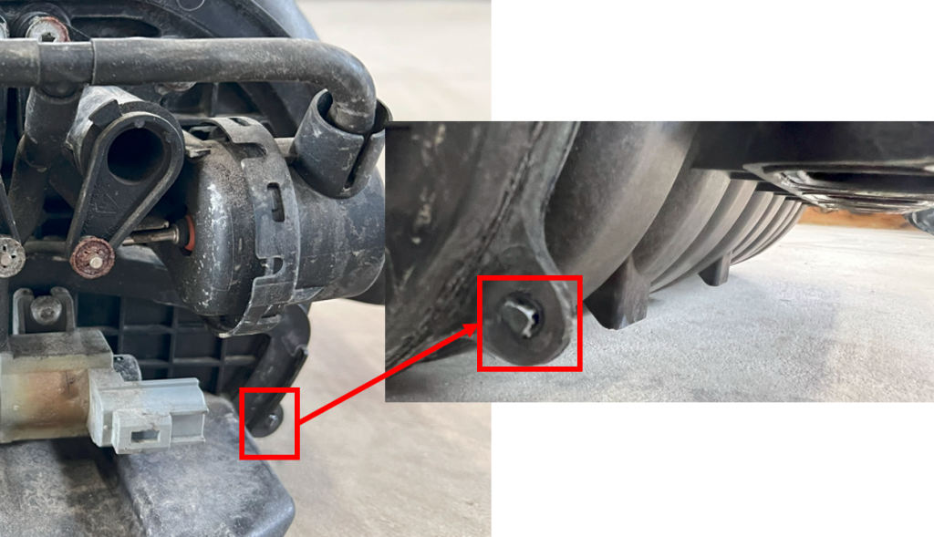

Finally there's a Christmas tree connector that is used to hold a wiring harness in place (passenger side); here the connector is broken and the Christmas tree portion remains in place:
