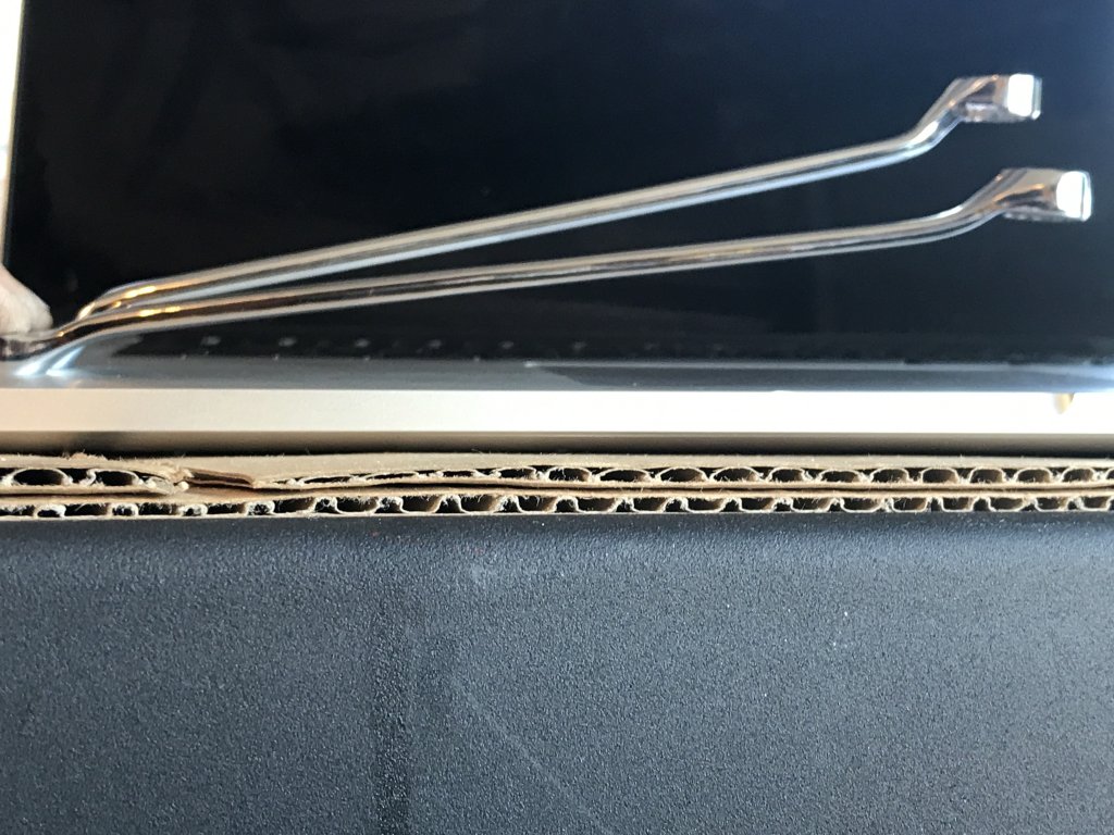

So, tool design: There are variations in wrenches, sockets, ratchets, etc not only in material and machining but design such as Snap-On have a half tooth offset for the 12 points in the end of a box wrench. This means that a zero offset can be flipped for each movement if space is super tight (flat, not a bent arm and head like you normally see).
(offsets: zero= angle of approach is flat and head is in line with face of wrench as opposed to medium or deep offset which will have the arm make a bend, then again at box head. A 10 or 15 degree is like you normally see on a combi wrench where the box head is right at the end of a straight shaft but is then bent about 15 degrees but not really an offset.)

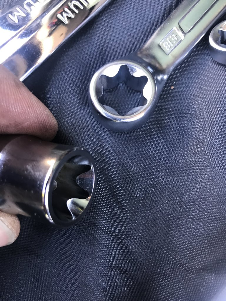

While on topic of hex and torx, the rovers have some stupid bolts that are "external torx" and even a very rare to me external 5 point. The E torx though is something Snap-On makes and maybe MAC. I'd have to check what part on the car it was, but it was annoying. Might be the drive shafts.

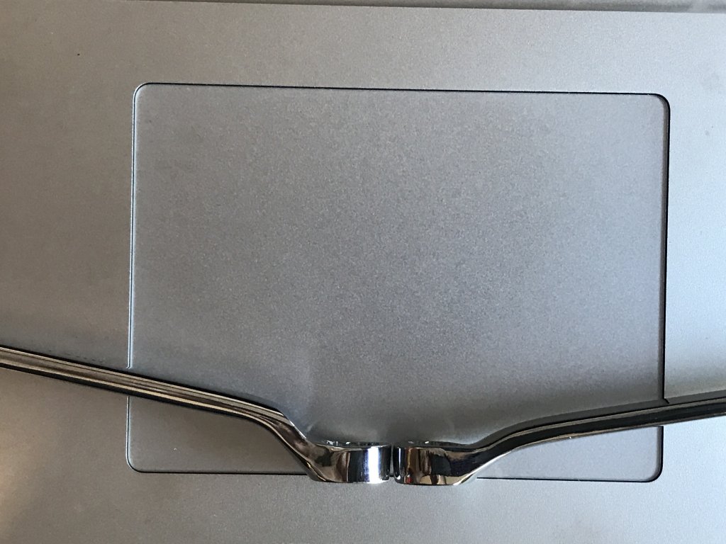

Slight differences in design
