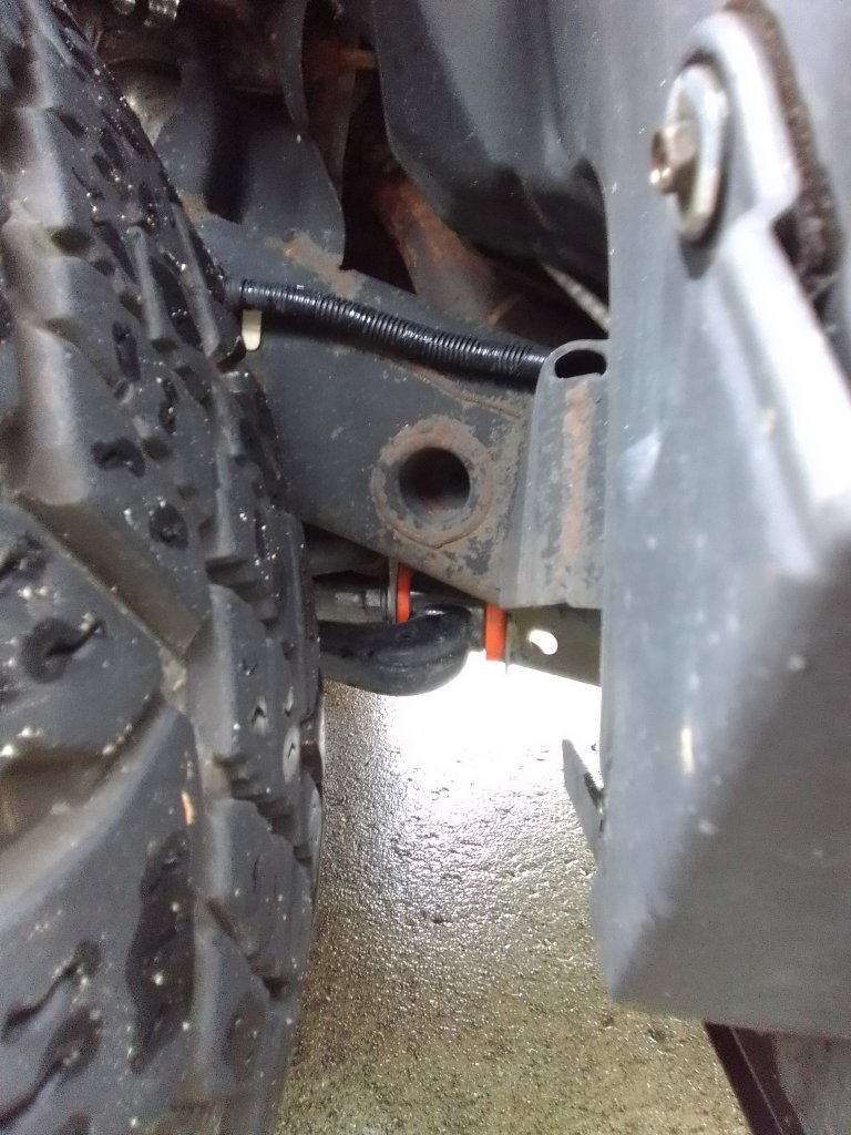

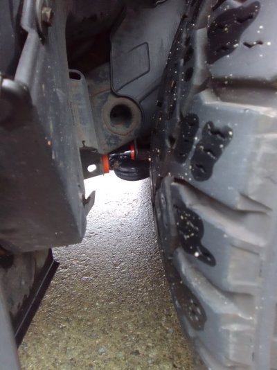

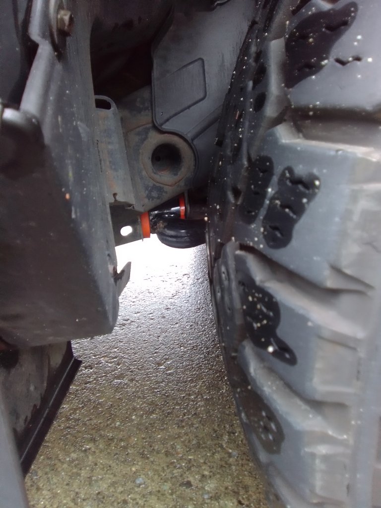

I think I'm probably good. This is what I could see from the outside in off-road height (Lt and Rt). I believe those orange parts indicate that the front control arms aren't original. Looking at the condition of them, they look pretty clean compared to the rest of the undercarriage. I've only had the vehicle since March, so maybe they were replaced not long before I took ownership.

LCA noise comes from worn out bad bushings. Those orange poly bushings will not flex much. So, whatever noise you're hearing is not the LCAs.

@djkaosone Thanks, that's a relief. Not hearing any noise particularly, but the ride feels pretty stiff over road imperfections. Perhaps the poly bushings would explain that. If so, I'm fine with it. Just wasn't sure what a "normal" ride should feel like.

yep, the poly bushings will trasmit more road imperfections and vibrations to the steering wheel; will feel more stiff than the stock oil filled rubber bushings but will last longer and are easier to replace without replacing the complete arms
