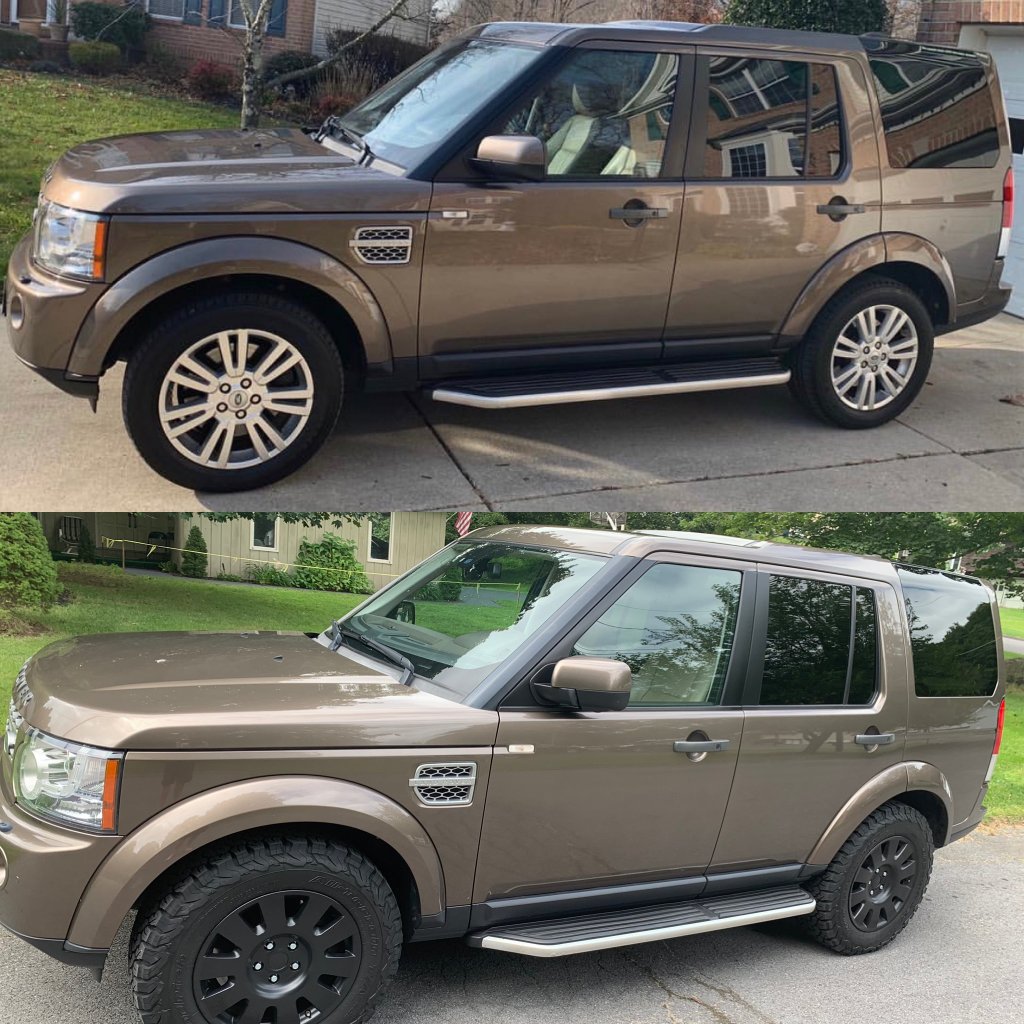

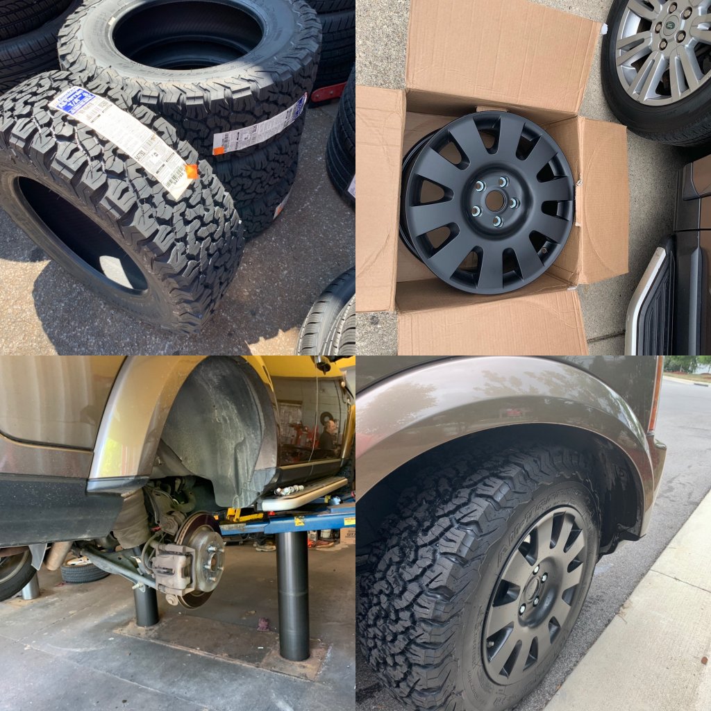

There are plenty of posts on this, the go to setup is either the compomotives or the LR3 18" wheels with 1.25" spacers. I did the spacers with BFGs and am very happy with it. It give it an aggressive wider stance, although I'm probably wearing out my lower control arms faster :)

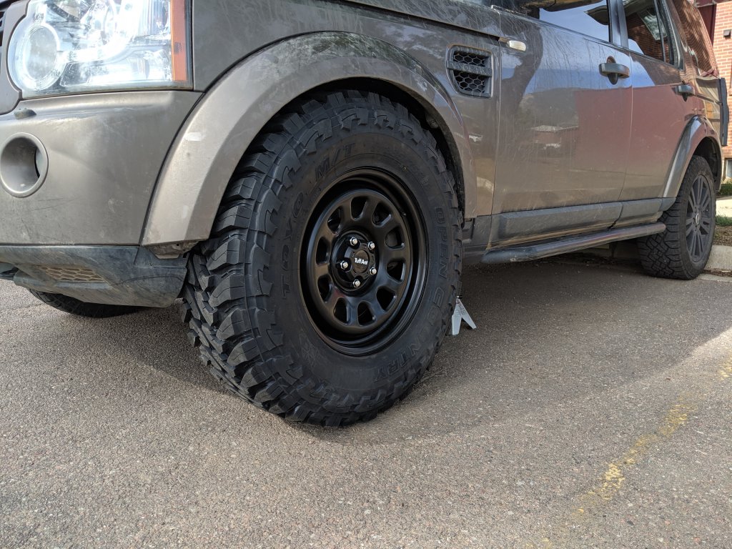

Mud Tech 18x8.5". Raid wheel.
265/65R18. BFG KO2
no rubbing, or modifications required.

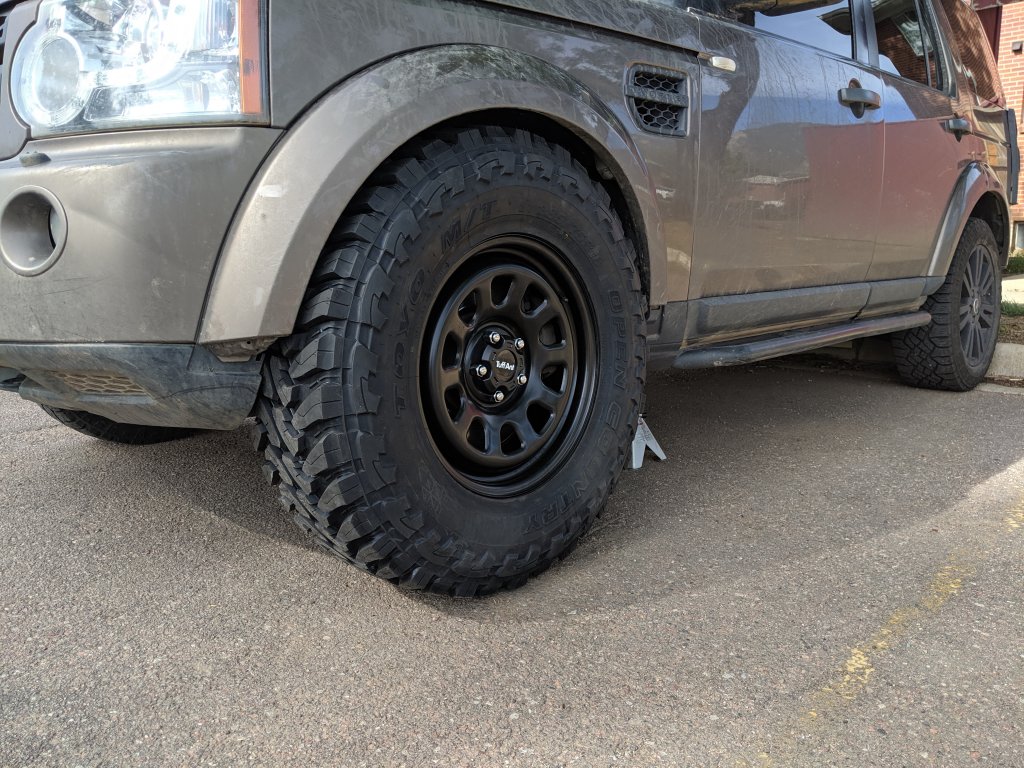

what kind of sliders are these? they look more low profile than others i've seen or is it just the perspective of the pic? (most stick out more, slightly past the wheel well...)
These were installed when I bought the truck, but I'm assuming they're stock. No branding on them
