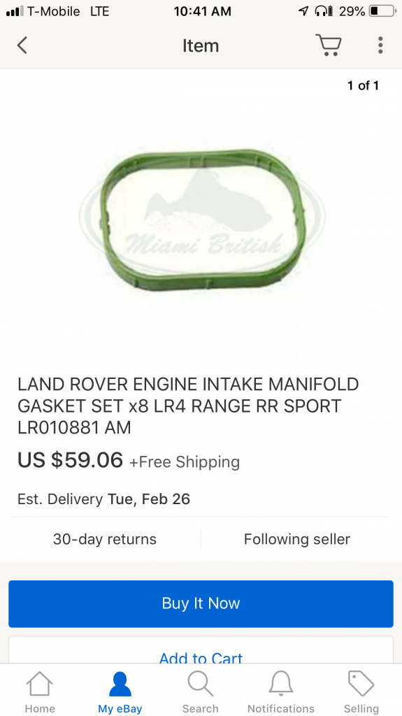

Thanks, was it necessary to take the throttle body Apart. I’m assuming for more space and did you need to put on a new throttle body gasket and intake manifold gaskets. And I noticed after the car sitting for hours, after I unbolted and pulled up the manifold, there was more coolant coming out. I didn’t know what the hell was going on
You’ll need to either take the tb off the manifold or disconnect the hose on the bottom of the tb. Either one will work... I did change my gaskets on both the intakes and the throttle body, but not necessary if they are in good shape. You do need to pull the manifold out. It likely is possible to do the repair with it in, but I can’t see how I could have done it without removal.
