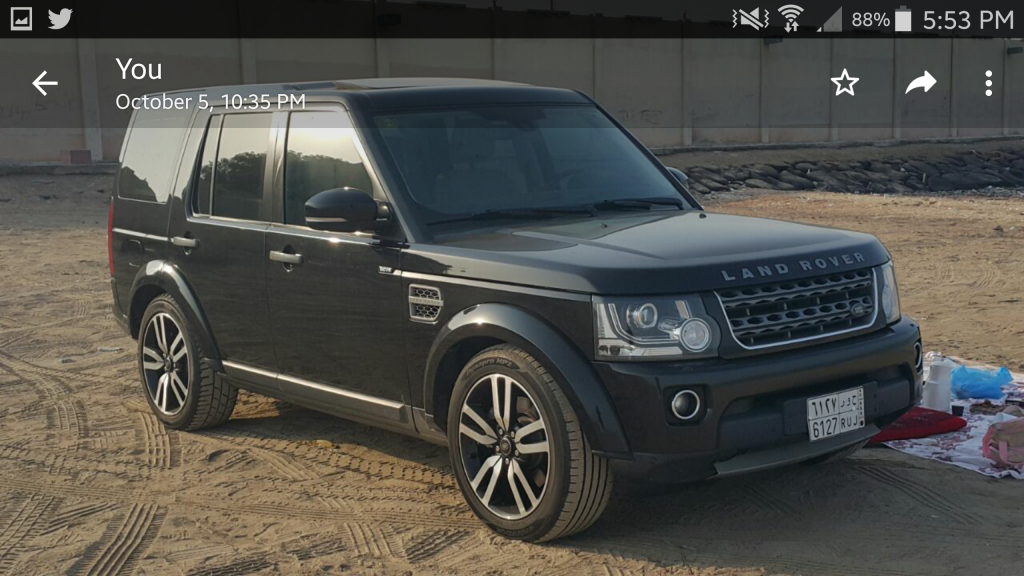

I have been suffering to find BFG KO2 275/55/20
Sadly all i can find in my country is BFG KO2 285/55/20.

Attached are my 20" rims incase any recommendations regarding size,should i gave up and install KO2 285/55/20 or charge extra 250$ for shipping fees and purchasing KO2 275/55/20

Thanks all for reading and participating and i am 100% sure that my question is repeated one, but i must make sure that 285/55 will not have any rubbing or other issues to the car. Specially that sizes defer from each manufacturer to another, and apviously between A/T and M/T.

Unfortunately the lr4 cannot handle 285/55 without heavy modification. I believe the largest tire you can fit is the 275/55 and that is with minor rubbing.
لا تتهور;)
Thanks for the feedback i am going with 275/55 for know untill i can manage to find some 18"/17" rims that is awesome.

FYI and thanks to the thread first and second to equilibrium. Know the 275-55 are installed almost perfectly. Still have rubbing issue on the rear/front left tires when lowering or left full steering.
