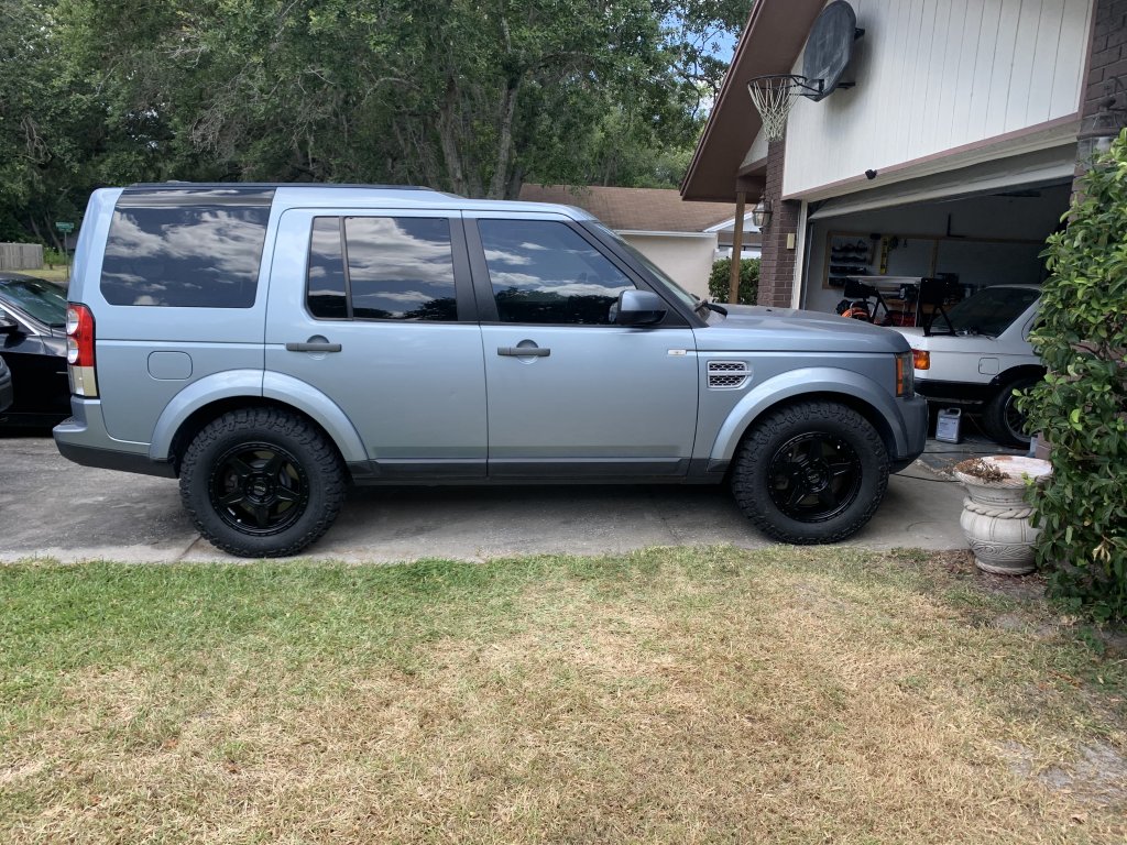

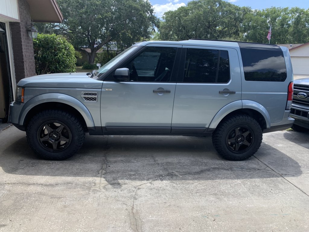

so it turns out there are plenty of wheel options if people are willing to at least look.....
Discoverer Rugged Trek 265/65-18's

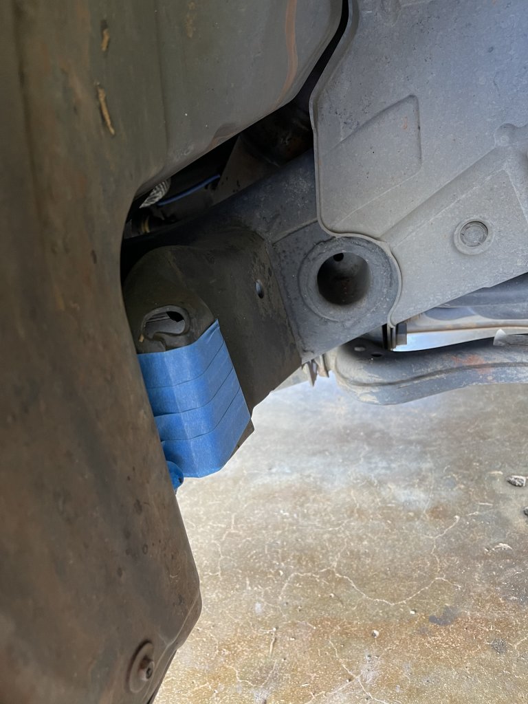

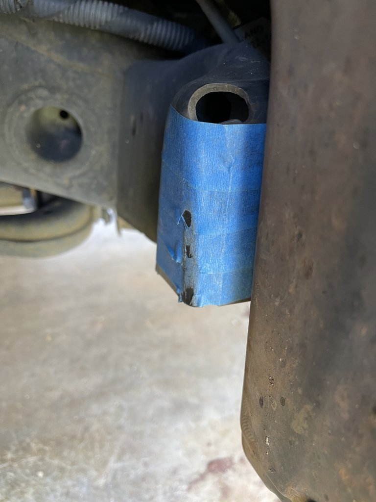

Finally found some frame horn issues. I purchased some TuffAnt steelies for my 2013 lr4. I bought some Goodrich MT KM3 265/60-18s. At full lock the tires hit the frame horns and the question of cutting and welding a plate to be flush with the tire well is an issue.
opinions and comments are welcome ... the question is what are the safety issues with cutting the frame horns by an inch?

If its just a little rubbing, personally I would just leave it. The tires will eventually wear down.

Also would love to see your rig with pics of the KM3s. I’d also guess you should run them to see if they’ll wear in before cutting the horns. But from my limited understanding and speaking to a fabricator, frame chop with a new plate will not damage the frame. The GX460 guys do a lot of frame chops also for bigger rubber.

I have the ET 27s offset and only 1 tire on a rim. The rubbing is only on the left/drivers side with
a slight rub. The pics show how much rub I get using one tire and will get a better idea when all are mounted.

If that’s it my feeling is that the tires will wear in a bit and rub goes away. You could avoid full lock pretty easily I bet.

That looks pretty minor if it’s only at full lock. Let us know how the rest fit.
I believe the ET27 is more likely to rub than the ET44’s - we have less data on the ET27s on this forum as I think that wheel is newer.
