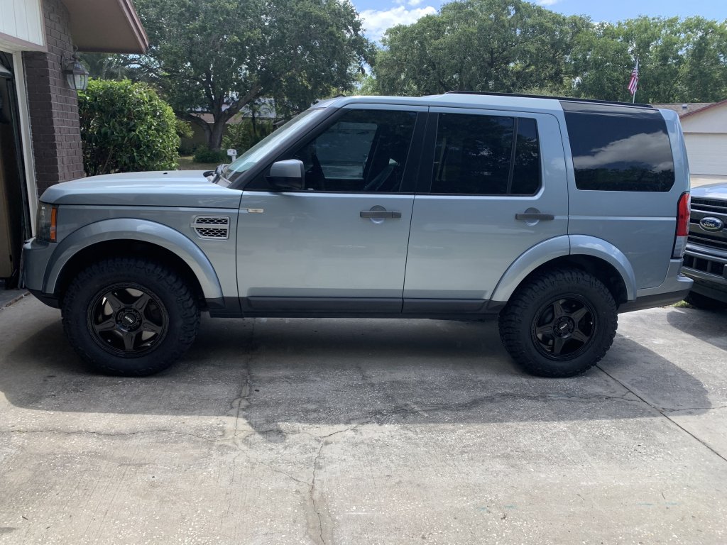

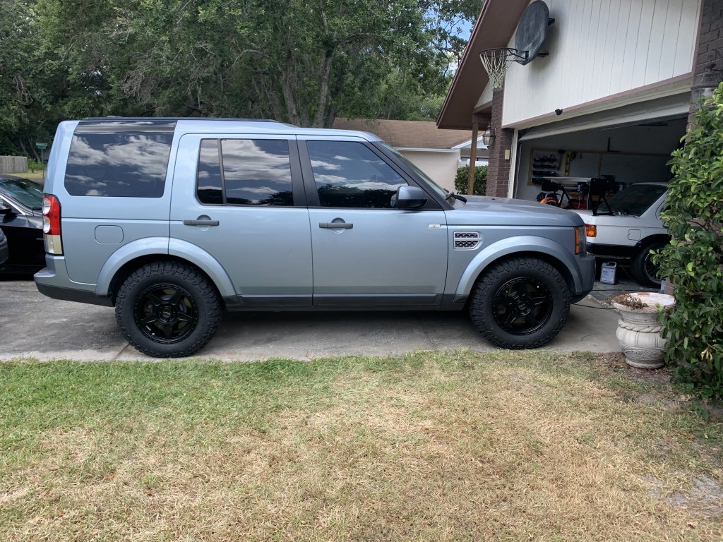

Sooo late to this thread ha. FWIW I run ko2s 265/65 w the 18 in Compos on my 2013. With a Gap tool lifted 1.5in full time, I have no rubbing, spare fits deflated at about 18psi. Ride has been fine on road and hwy. my 2011 lr4 has stock 19in size Geolanders it handles and rides a little softer, the ko2 E rated are stiffer around town but seem equal on the hwy. I ran a285/60 ko2 at first for about 40k miles, this was what I had on my lr3 too. They did slightly rub at full turn bf they wore down. In the end they looked too wide on the lr4 to me.

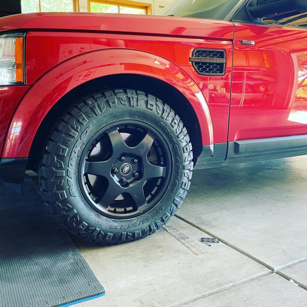

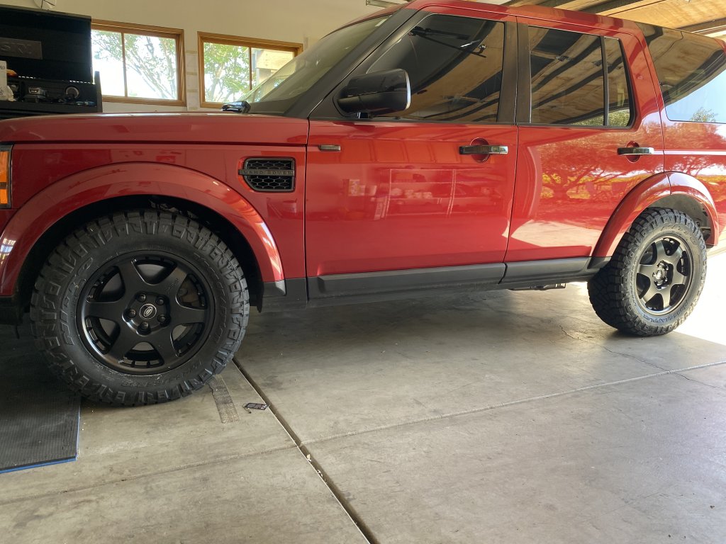

Thanks! I actually cheaped out on the spare. Was hoping to sell my 19's and then pick up the 5th. GAP tool. You gotta get one. It's a diagnostic tool that plugs into your OBD port and reads faults/codes and allows all sorts of customization via a smartphone app. You can read about it all over the forum. You can get a discount through Lucky8 as well. The tool allows you to change your suspension height and many, many other things. I installed the Compos and programmed in a mild 10mm lift. I'll post some better pics a little later. I'll also use the tool to retrofit paddle shifters and "activate" them to work on my '12 as the 6-speeds didn't come with paddles from the factory.

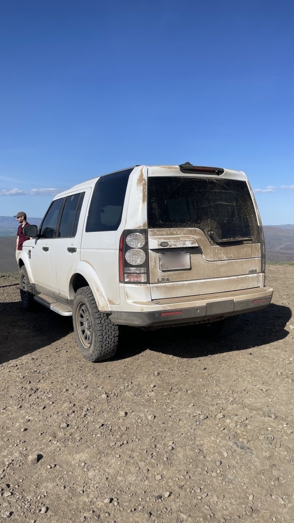

On my 2015, compos, BFG KO2 265/65 E rated, on bump stops, nothing rubs at all. Had suspension freak out at the end of an off-road day, and had to limp out 1/4 mile. No issues or damage and there was still enough gap for the tow truck to get straps around wheel. Ended up just needing a lift to get suspension extended and all good but excited the wheel/tire combo worked so well.
