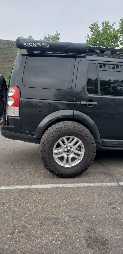

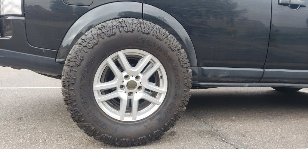

Here's a preview of my new tire 285/70r17.

I'm currently running 255/70r17s

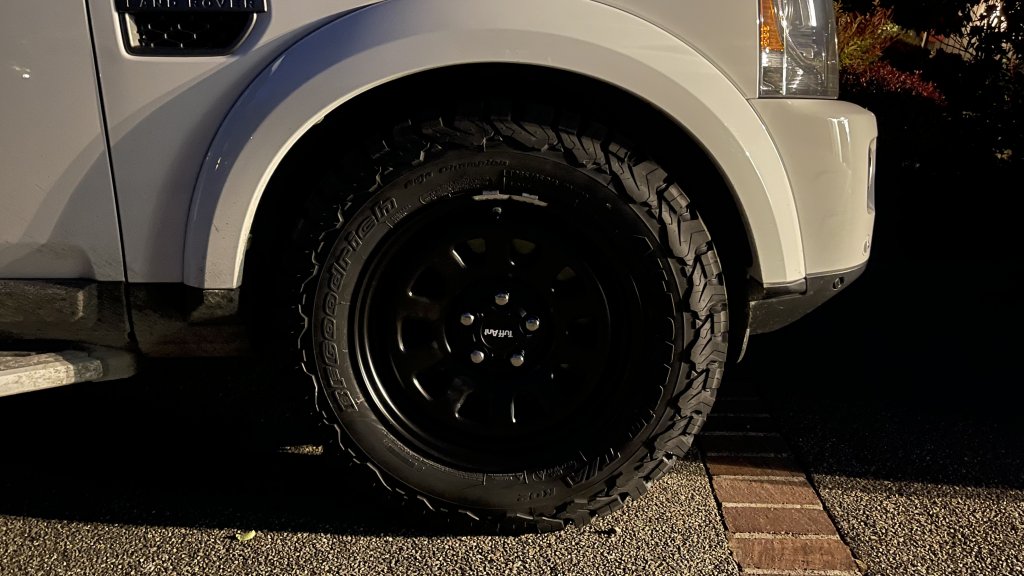

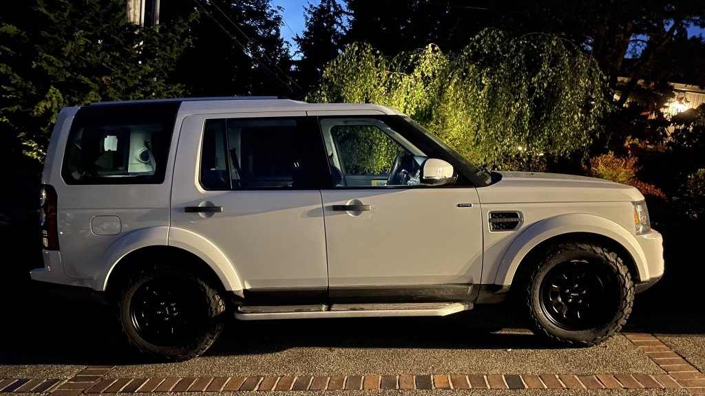

@adclark and others - my Tuffant 18" steelies are being delivered today, and I will be fitting them with 265/65/18 KO2s tomorrow. Will let you know of any issues with 1) rubbing, and 2) fitting in the spare.
My expectation is that it will rub when in access height OR perhaps even in Normal height at lock, but I am hoping that will go away with wear. I am also expecting that the spare will fit when deflated to 15psi or so.

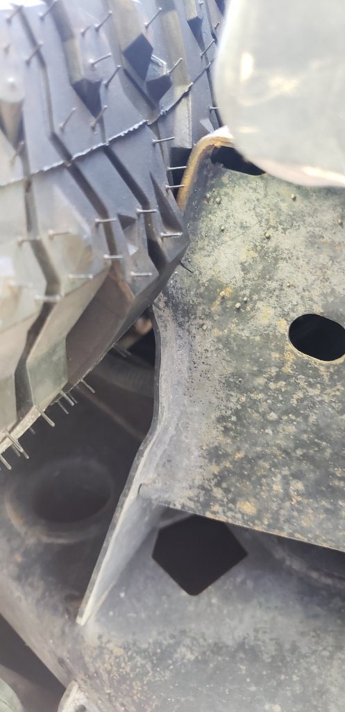

Installed the 265/65/18 ko2 with Tuffants. Some rubbing at full lock in normal height, but not too much. Will examine wheels tomorrow to see where exactly. Also, the spare wouldn’t go in unless deflated, so I’ll need to carry my compressor at all times (used to do it only for off-road use).

@Haris Looks good! I assume you're paying attention to where things are rubbing. To my mind, ANY rubbing is not good, because either the tire is going to lose the battle, or something else will.
Yes, I'll be reviewing it today in daylight, to see if I need to do anything about it. I expect its happening at the frame horns as others have mentioned above. I feel that since turns at full lock are rare, I'll just be more careful with those. I have heard that as the tires wear out more, this situation fixes itself. Will see.
