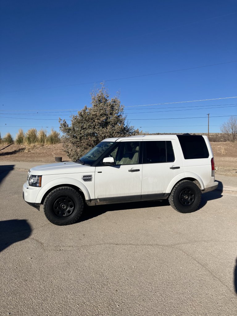

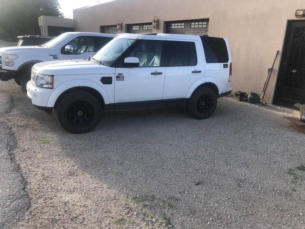

I went with the Lucky8 18 steel wheels and BFG 265/65/18 tires that come in at 30 inches. At stock height I get a little annoying rub at full wheel turn so I have purchased a 2 inch Johnson Rod kit to install. Ride is excellent and it loves the desert trails.
