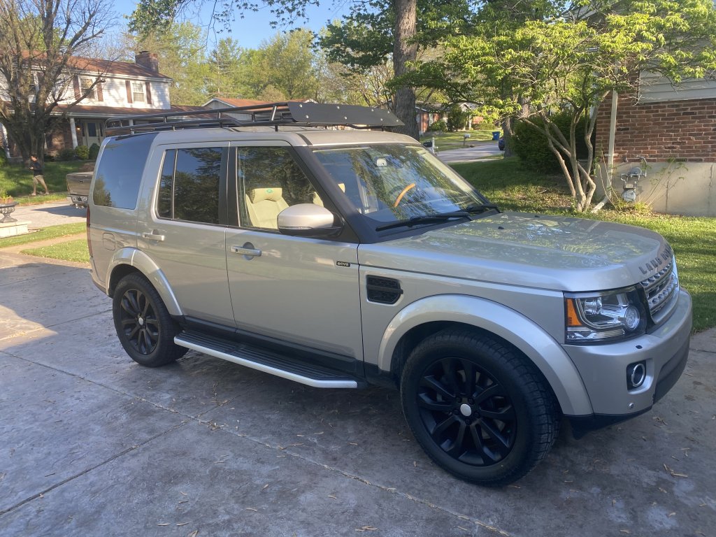

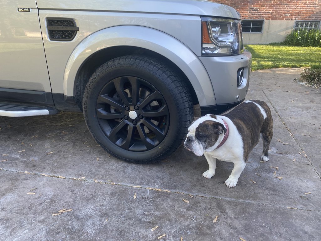

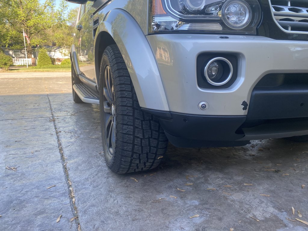

I put lexani terrain beast 285 50r20 on mine. Fits great no rubbing just over 31 inch diameter. 31.2 i believe
