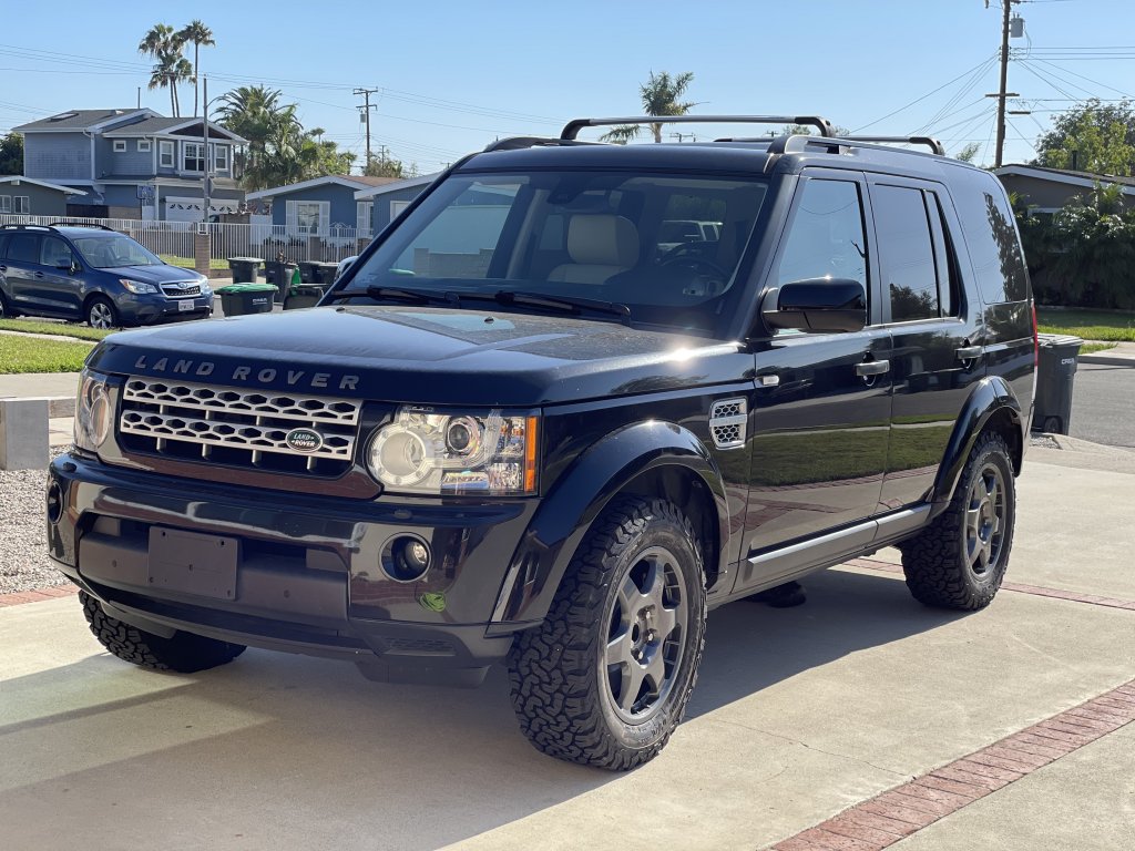

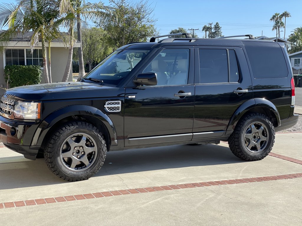

Just thought I'd share, I Finally got my Compos and 265/60r18 BFG KO's. Super glad I went this route, kept it simple, still feels like a luxury ride, and I can't wait to take it out next week. no rub and the spare fits. stoked.
RobRover88
Sep 3, 2015
121
93
Melbourne, Australia
G'day adclark,
Congrats on your choice of wheels & tires. Especially tire size. The 265/60's are a better option compared to 265/65's because it avoids ANY problems - rubbing & fitting inflated spare. The slightly lower profile has not
proved an issue for me in seriously rough terrain. I can air-down without problem, except I keep them a couple
of pounds higher than I would with 265/65's. Ride quality is excellent & noise is fine. Speedo/odo are still quite
accurate compared to OE wheels/tires. When time comes to replace my rubber I'll be staying with the BFG KO2's. They'll be my fourth set of BFG A/T's over two Discovery's since 1998.
