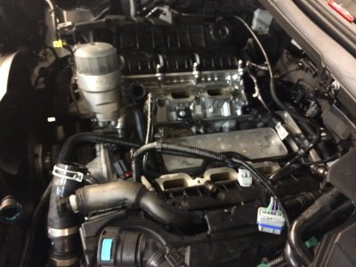

Hi guys... truck is scheduled to be finished today. Problem was confirmed to stem from a bad oil intercooler in the engine valley. See pic. It's the long / flat aluminum plate in between the intake runners. Oil gets routed through this part along with coolant. The coolant passage / lines were breached, this in turn allowed higher pressure engine oil to force its way into the coolant system. They reassured me that no coolant entered into the engine oil, I'm still suspect of this and will request to see oil sample test.

The following engine info has not been verified through any other means. To my benefit, I was able to speak directly to the mechanic working on the motor. My main focus was that of the AJ126 engine block design and related technical track record. While he didn't have much to say about the LR4 platform, he has seen this oil cooler problem in the Jaguar line. To his knowledge, the AJ126 block was put into service in 2013 and that it's design came from the European Ford division. I asked if there was a way to document oil cooler part revision number. Both service personnel were unaware of any revision numbers on these parts.
