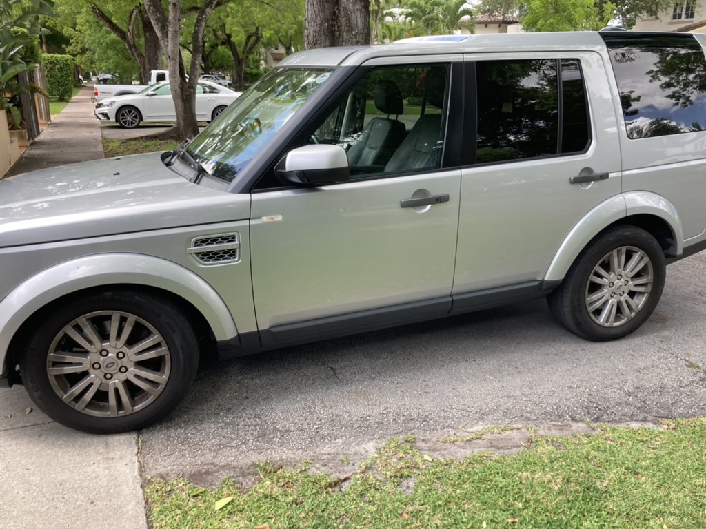

Not a great angle BUT my front end does the same ~ she's a 2012
3,032
1,803
The next time you'll be parked for a while (at least overnight), raise it to off road height, then turn the vehicle off. Pull the suspension fuse. Take a measurement of all 4 corners.
The next day, see what corner or side has sunk.
You could have a leak in just one of the front bags, but the suspension auto-adjusts itself (even when the car is off) so it's hard to tell which one. Pulling the fuse when you park will keep this from happening.
