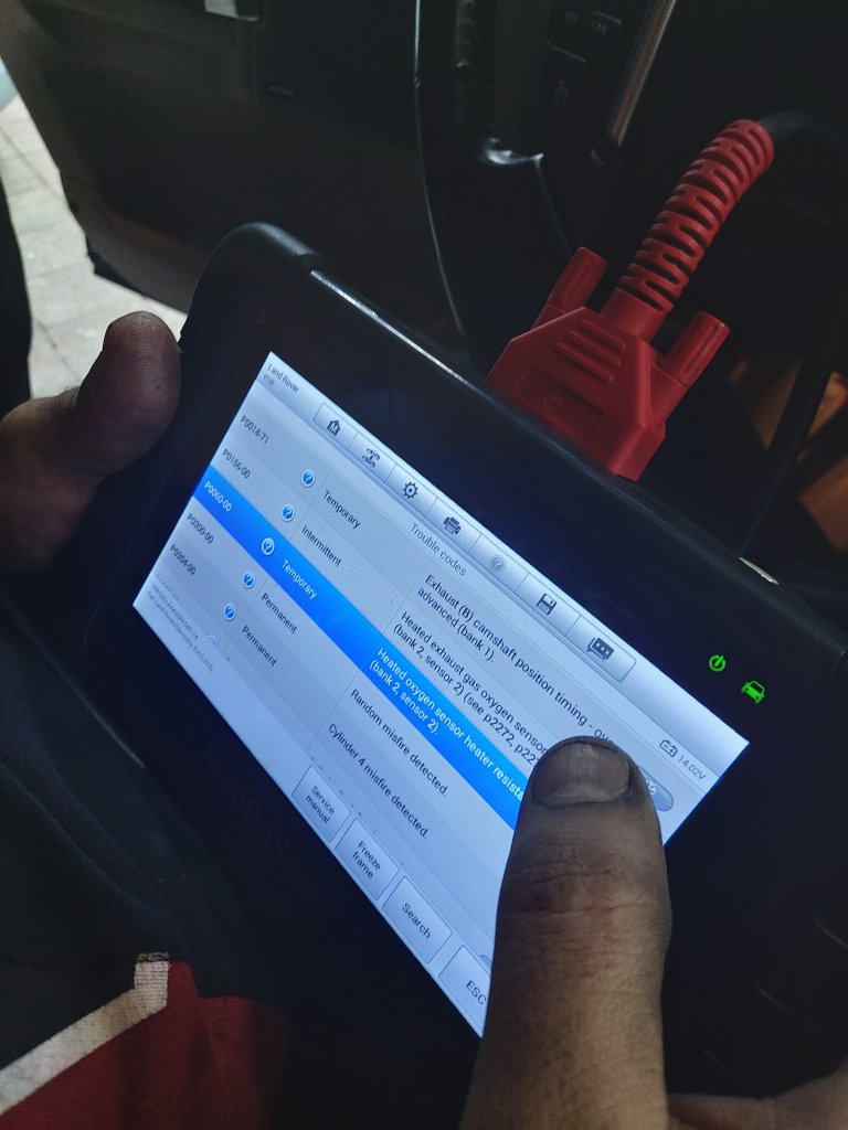

Again...CEL and threw codes :

I think your original post said no CEL, so is this new? You said no codes before, so I assume these codes in the screenshot are new. If you are not sure, clear all the codes and see what comes back.
From the codes on that screenshot, looks like you still have an oxygen sensor issue. If they were changed, you still have some kind of issue - maybe the wiring, maybe an intake or exhaust leak, maybe a fuel supply issue. That could easily be the cause of your misfires, although (from what I can see) there is a timing code for bank 1 and o2 sensor/misfire on bank 2, so not sure what is going on with bank 1. Still, if that o2 sensor code keeps popping up, I think you tackle that first.
Will that device show you fuel trims?
You sir, hit the nail on the head, needed to change the camshaft and sprocket on bank 1 + fuel pressure sensor + bank 1 valve cover (vacuum leak), CEL's dissappeared completely but the shake was still there, albeit less pronounced.
Indy raised the engine off the mounts, car was silky smooth, upon removing and inspecting the mounts they appeared to be some chinese s h i t e, replaced with original Land Rover.
All sorted now
