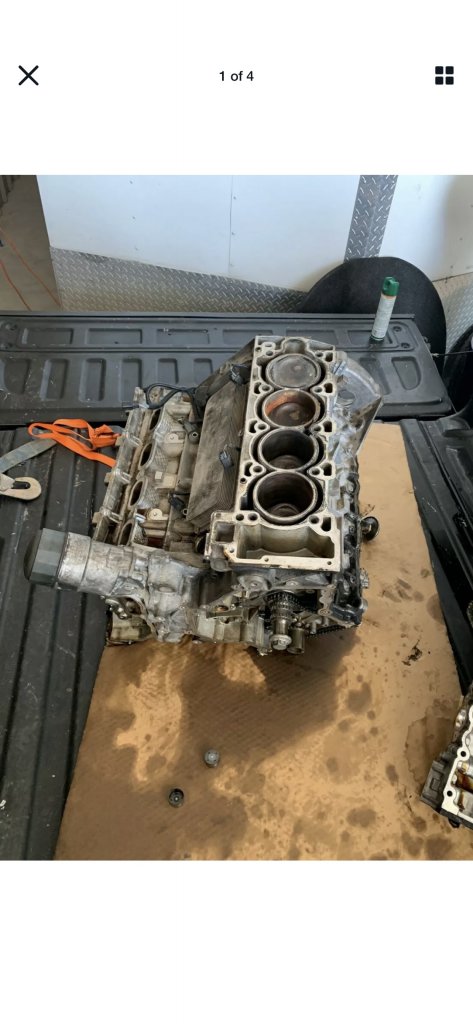

Could you elaborate on the Re-sleeving and why that is not possible? Not trying to argue or anything, just trying to learn! :) I was doing some researching this morning and re-sleeving aluminum blocks seems relatively common? I couldn't find anything specific about Land Rover 5.0 engines though...

To be perfectly honest with you, I can’t give you an exact reason as I’m not an expert in this area. However, I do know that I have been told by several LR engine specialists that the 5.0 block is not able to be repaired should you blow a cylinder.
If I had to hazard a guess, it’s because the sleeve isn’t flanged, and all the cylinders are cast together. There’s not any room to machine a flange groove for the new cylinder. Almost all the previous blocks, 4.4 & 4.6 for example had “top hat” sleeves, which allowed them to be replaced....it also cause A LOT of problems with sleeves coming loose or cracking.
When you look at the inside of the block, all 4 cylinders are cast together...so you’d have to replace them all....and I don’t know if that’s possible with the way the block is designed. Just look at the pic below. I found this one on eBay:
