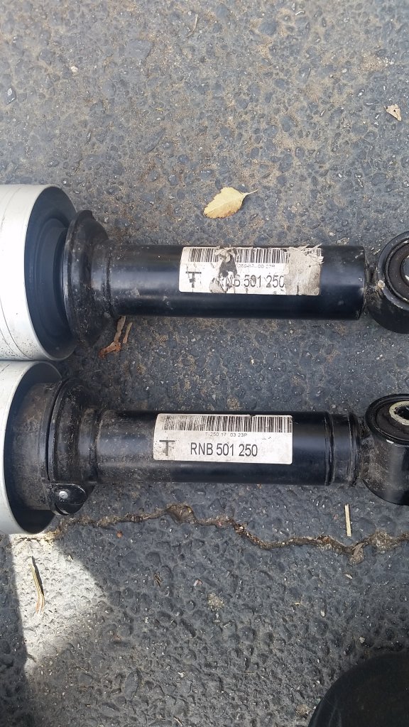

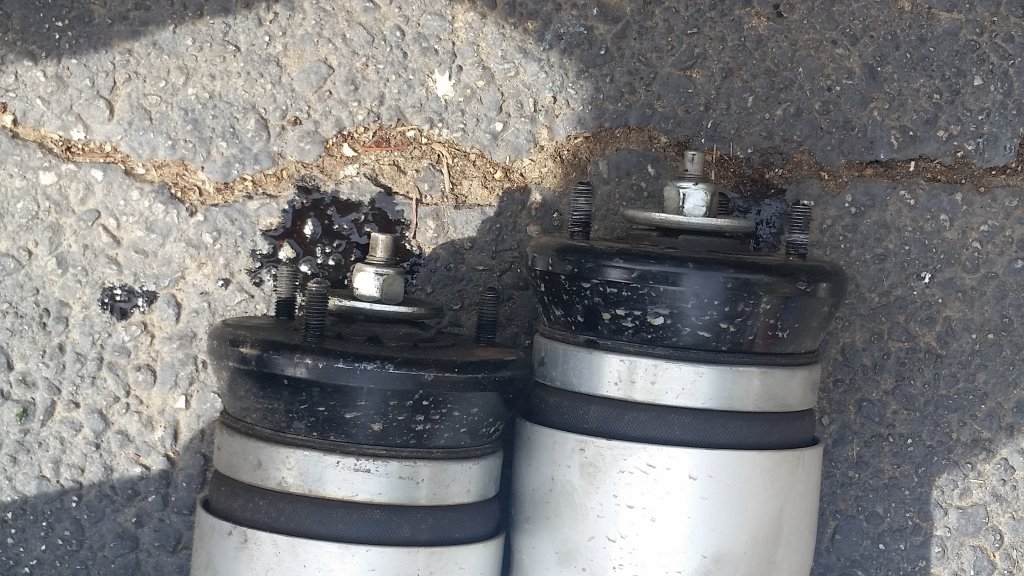

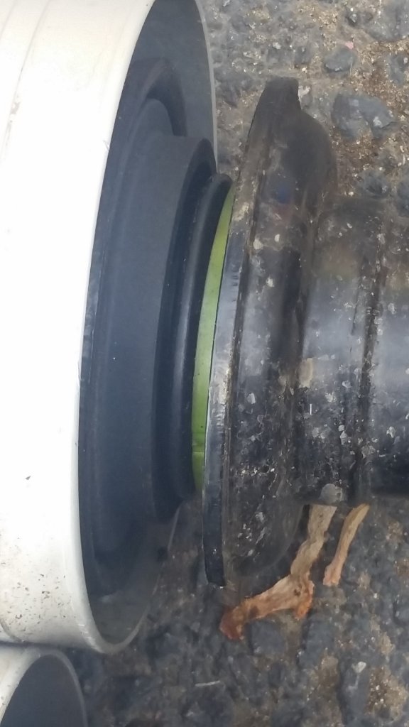

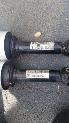

Just finished replacing my struts. at $239/air bag and only another $50 or so I would get the struts and did. Only pain in the **** was putting the airlines back on in the limited space.
