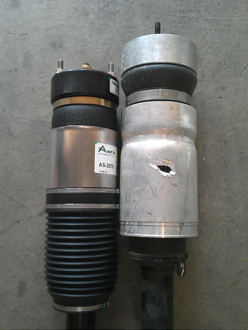

After my blow-out, I reinstalled the old "bags" I took out. After rolling on those for the last several months I decided it may be worth the exercise to buy a set of Arnott "bags" . . . . was quite surprised at the quality.
The Arnott design uses a Bilstein shock and Goodyear bladder that appear to be major upgrades compared to the Delphi OE design.
Here's a pic of the Arnott and the OE (one of the brand new Delphi that I blew). The circumference of the Arnott is smaller than the OE by roughly 3/4" (checked it with a pie tape). . . .
