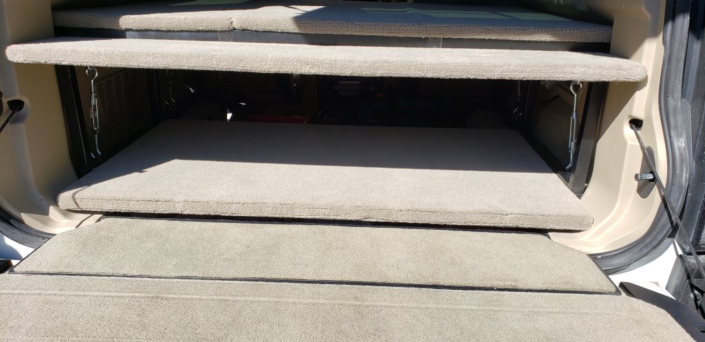

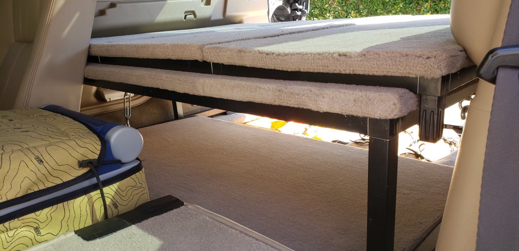

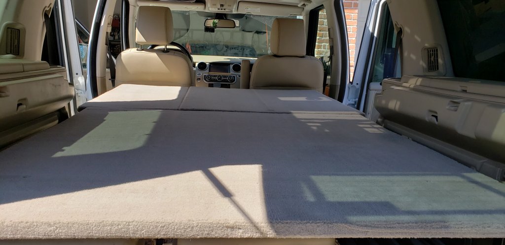

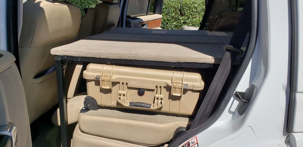

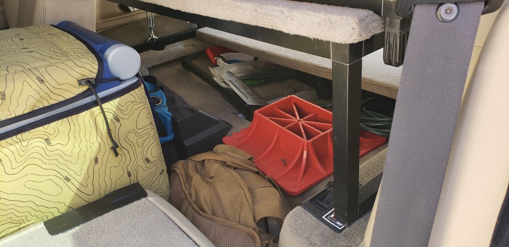

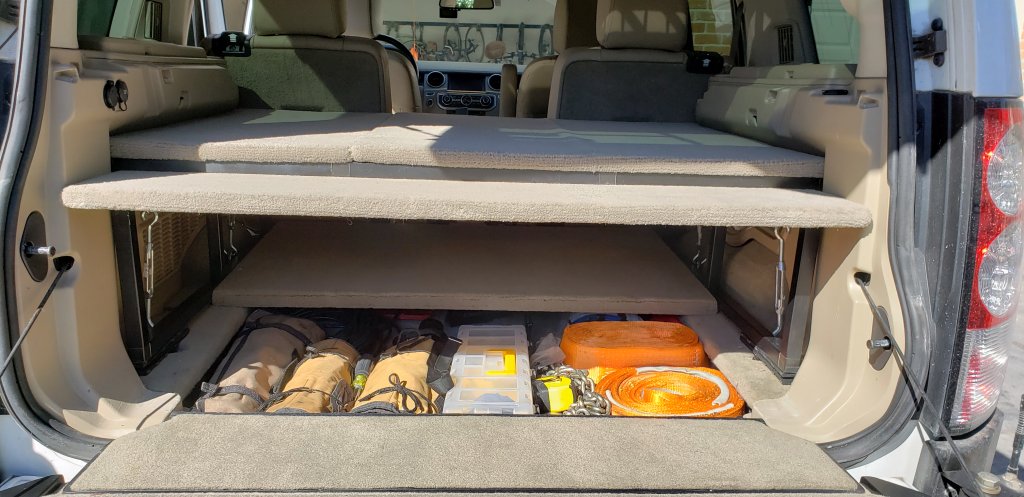

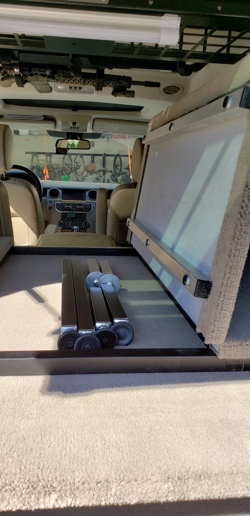

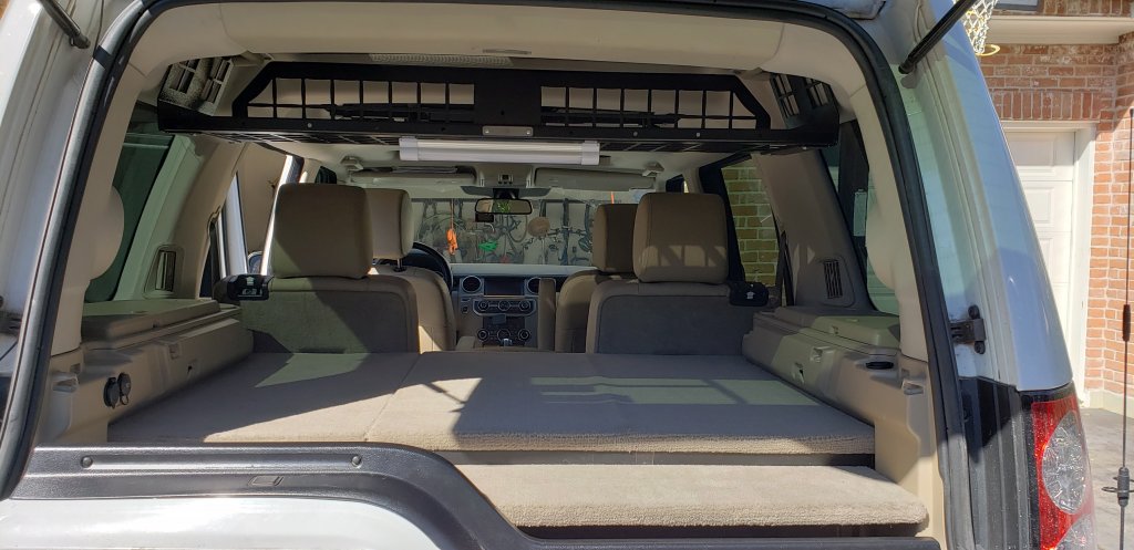

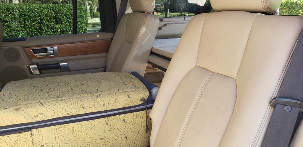

Nested position of the platforms

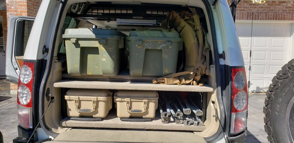

Nested position showing the lower slider that allowed access to storage where 3rd row used to be, as well as more flat storage on top.
Forward view with slider pushed full forward.
Slider pushed back to access storage behind second row.
Slider all the back.

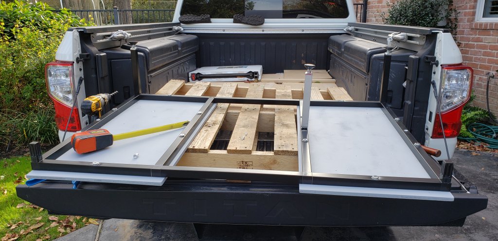

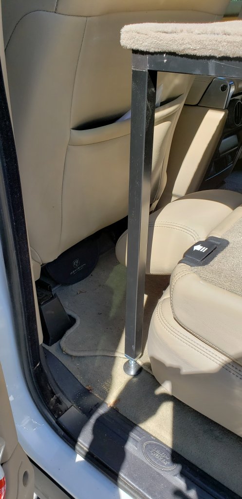

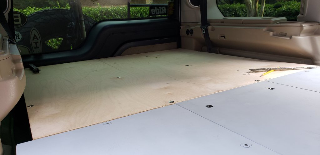

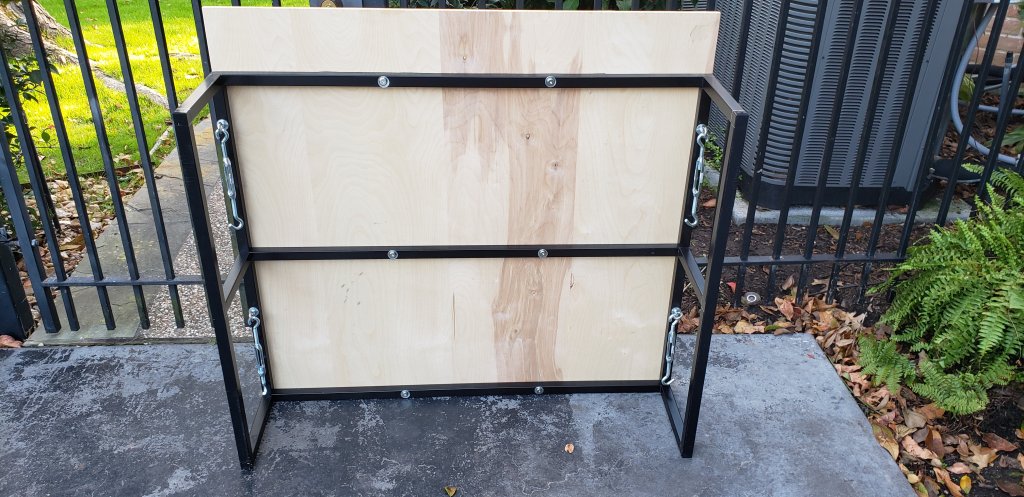

Pic showing the framing of the forward platform.
Pic showing the framing of the be rear platform.
Pic showing the T-nuts used to secure the plywood to the frame, and also the primer coat they got before upholstery to seal the wood.

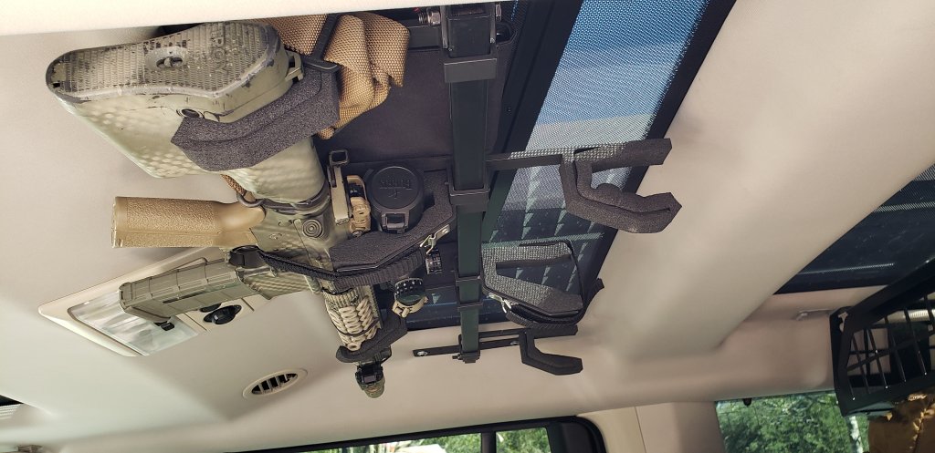

Rover defense weapon is right handy from sleeping position.

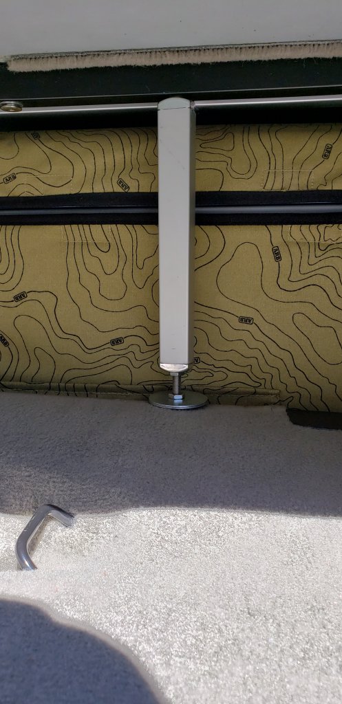

EZ-Tube aluminum tubing, steel core connecters and adjustable feet (this stuff is fabulous, not sure how I lived without it before)

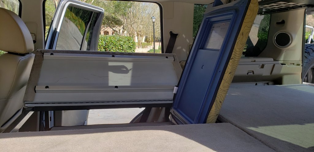

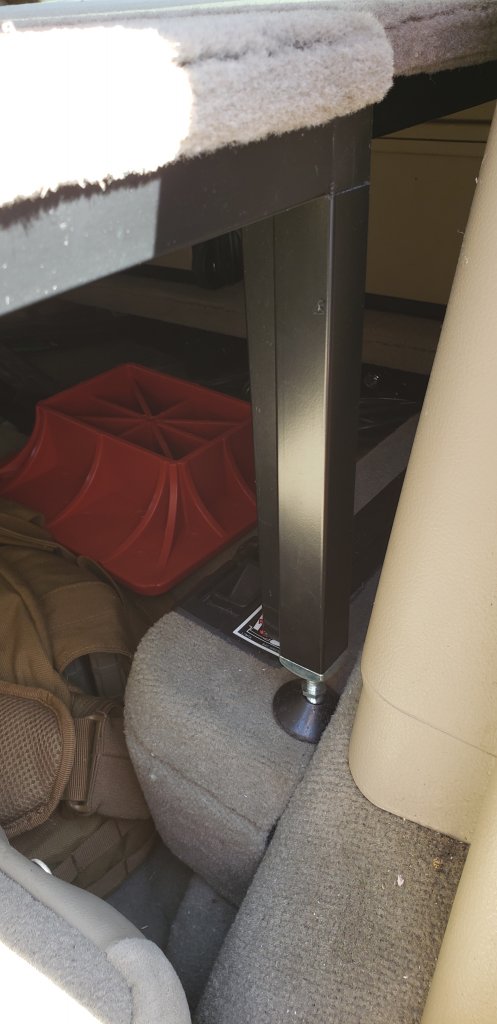

Make the flip open panel 1" wider on each side. What I did works, but widening it by an inch would allow the support leg to rest squarely on the folded second row seats. I was tying to maximize space available under the platform so I came up with the "washer" method that you can see in a couple of the pics. It works, but I'm not sure the extra hassle was worth the extra inch of space under there.
Take the flip panel to a cabinet shop and have them route/mortis or whatever they do to install a set of hidden/flush hinges. I used piano hinge, and while it works you can definitely see the ridge of it under the carpeting. Doing this would also allow the flip panel and it's neighboring panel to be upholstered completely separately so you wouldn't end up with a wrinkle of carpet when the panel is flipped open.
