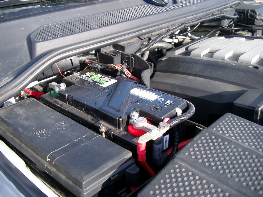

"Never designed for AGM" - that is an interesting thought.
It is one I never thought about but yes, per the jpg, my 2005 factory battery was one of those low maintenance lead acid batteries with the sort of removable flush caps, but not the older style screw caps.
I always wondered why the LR4 has a Car Configuration File (CCF) switch for battery type - never thought about the increased charge voltage that the AGM wish to see.
I also know that there was a change in "smart regulator" design re the 3's but never really understood what that was about. In saying that, my information is that the battery charge voltage is set by the car computer software and not the alternator regulator as it is/was in lesser vehicles - that is all but the Land Rover.
The different charge voltage would be consistent with that switch in the LR4 CCF - the car computer software dictates battery charge voltage.
At the same time, I note that in colder weather the system voltage is closer to 14.5 VDC measured at the OBD plug so that seems adequate for the AGM charging. At the same time, 13.3 VDC is a number I see in hot weather and I suppose that is too low to charge the AGM..

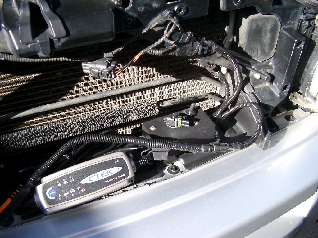

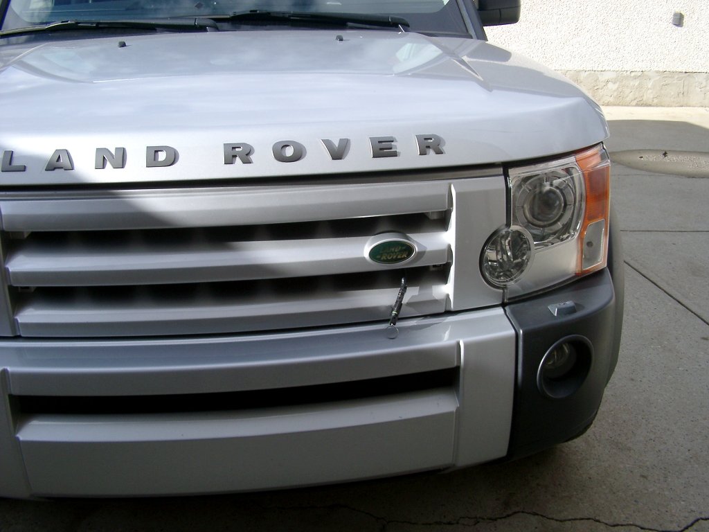

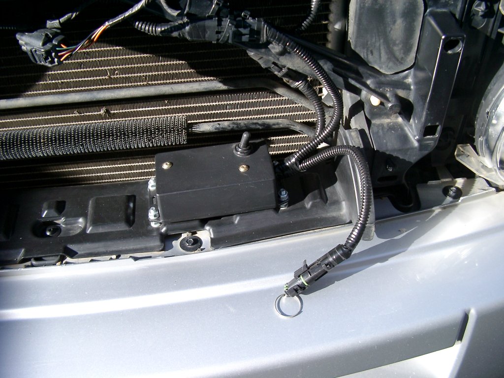

I did much the same but only installed connectors (Delphi Weather Pack https://theelectricaldepot.com/weather-pack-delphi-connectors?zenid=afaad1bd8a5f7d715509337017d83253 ) and a switching box to toggle between the cranking and aux battery of my Traxide system.
The jpg's below show the switching box, the Weather Pack connector that can hang thru the grill and the CTEK US3300 maintainer. I usually connect up the batteries about twice a year. It takes a week of charging overnight for each battery to bring them back to where the maintainer just sits on float.
I do have a cigarette lighter connector type solar panel that I have used as a battery maintainer for my plane but do not use any longer as the plane is now hangared and is hooked to a power cart.
I could set the panel on the dash for when parked all day outside and plug it into the aux socket that is now connected full time to the battery independent of the ignition.
