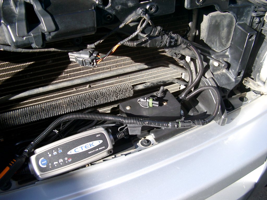

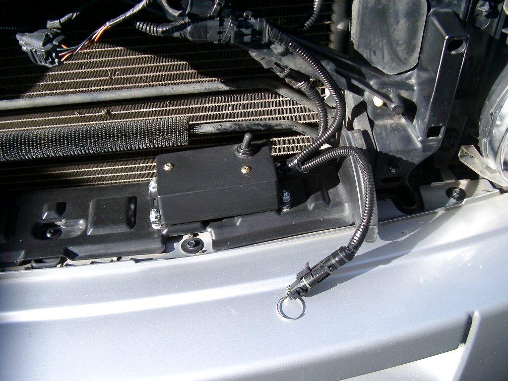

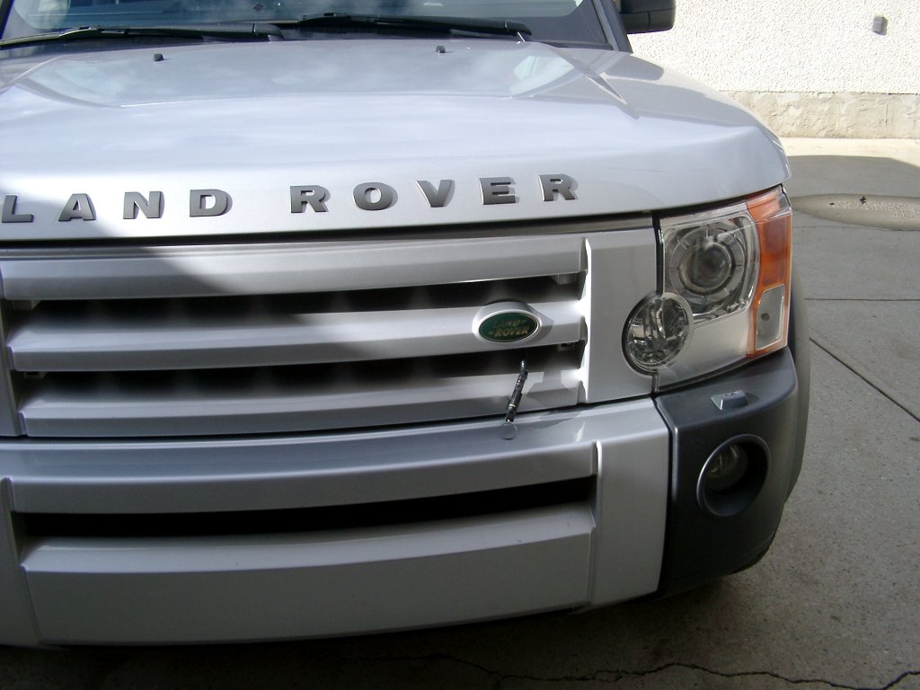

I did much the same but only installed connectors (Delphi Weather Pack https://theelectricaldepot.com/weather-pack-delphi-connectors?zenid=afaad1bd8a5f7d715509337017d83253 ) and a switching box to toggle between the cranking and aux battery of my Traxide system.
The jpg's below show the switching box, the Weather Pack connector that can hang thru the grill and the CTEK US3300 maintainer. I usually connect up the batteries about twice a year. It takes a week of charging overnight for each battery to bring them back to where the maintainer just sits on float.
I do have a cigarette lighter connector type solar panel that I have used as a battery maintainer for my plane but do not use any longer as the plane is now hangared and is hooked to a power cart.
I could set the panel on the dash for when parked all day outside and plug it into the aux socket that is now connected full time to the battery independent of the ignition.
I think we discussed this at some point.
I just rely on Traxide's affirmation that both batteries will be fully charged regardless of which one is connected to a charger. I have my underhood charger connected to the cranking battery, but my volt meter tells me that both are, indeed, charged after the charger has kicked into float mode and I disconnect it.

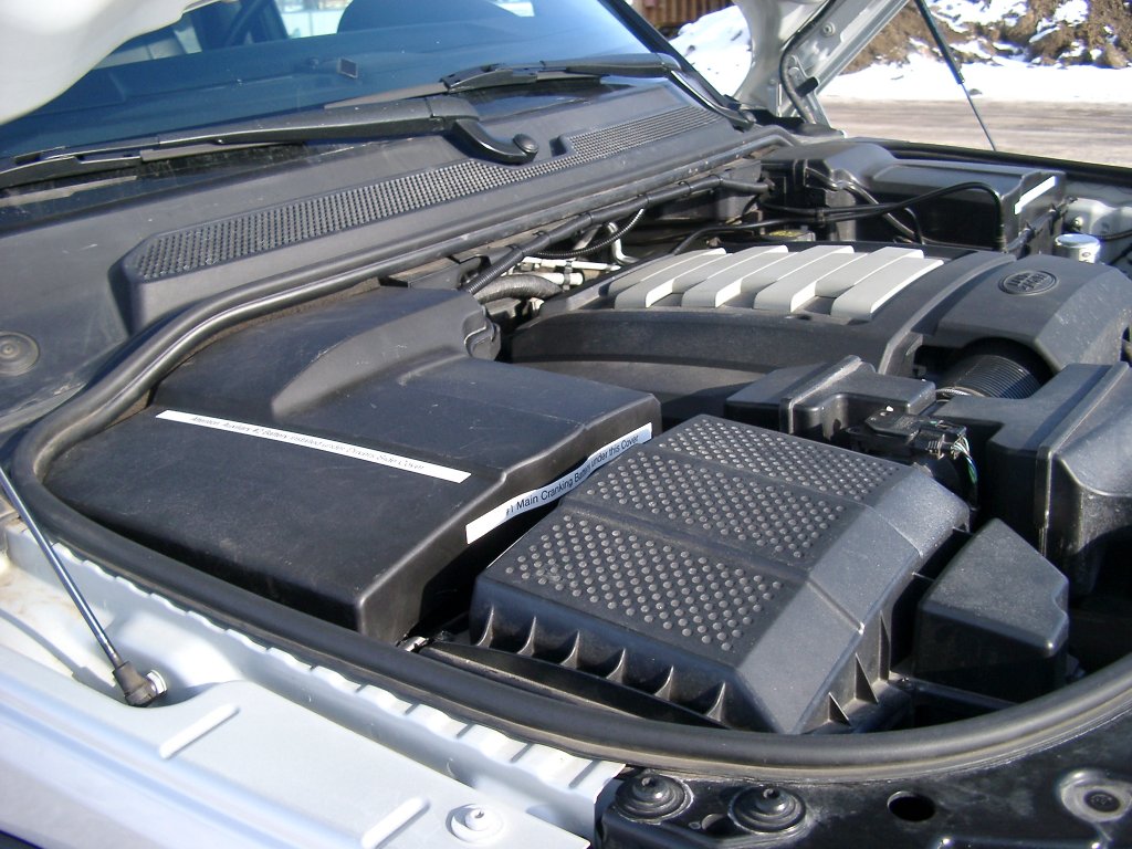

As to the earlier post about a Group 31 battery, if one is willing to ditch the battery covers, I think there is a reasonable chance that would fit. Just judging from the random things I have left lying around the engine compartment when working a still managing to close the hood. As to whether the cable would fit; I would think some modification would be necessary there.
1,415
Has anyone tried a group 31? 31’s have a reputation of being built better than standard auto batteries and will have more CCA and Res capacity than a H8/49 battery. A 31 will be more of the size of a H7 LxW but is about 2inches taller than a H8 or H7. Just not sure if the cables will reach and if there is room under the hood for the extra height.

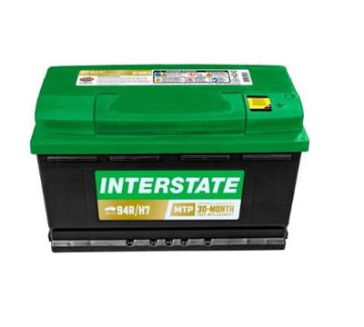

I am thinking that next time around for new batteries, I should try to find the older "maintenance free" battery design. I will still install the H7 size as for me, getting older, it is tough enough to get the H7 in and out with out struggling with something an 1-5/8" inches longer and 5 pounds (49 vs 54) heavier.
In fact my deal with Interstate is that I will do the hookup etc but one of the young guys will have to lift out the old one and set the new one. Stay young!
I might note that I do not like the look of a battery with a green plastic top cover - something is just not right and hence the factory battery covers remain very much in place - no Group 31 for me.

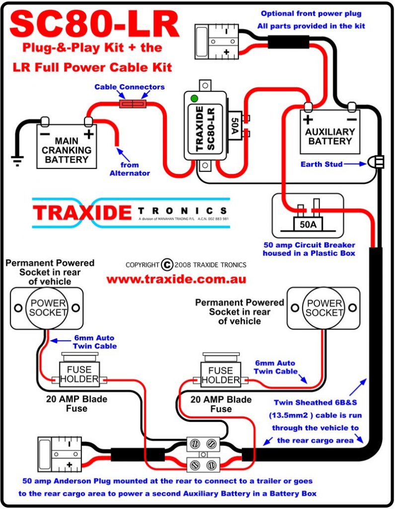

I have the older SC80-LR controller which does not have any sort of interior mounted control box.
I have thought of upgrading my SC-80 to the SC-160 with the control box but have yet to do so.
The truth is I am not certain just how or what the limitations of the older unit is, however it does work for me.
I have yet to be stopped just because one the the AGM batteries did the instant fail thing - one of them seems to keep the 3 going. The more I think of it, I might just go back to the older maintenance free battery next time - at least the top of the battery will be black and maybe they will fail slowly as I was once used to.
