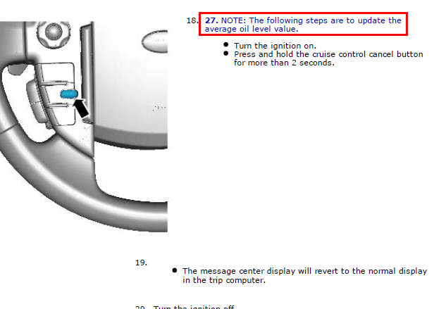

It is NOT clear at all. Make sure to read all the way to the end of the procedure... snippet below from the V8 manual, steps 18 through 25.
The SCV6 manual doesn't seem to mention this... I'm not sure if it applies to 2014-2016 models or not. :oops:
