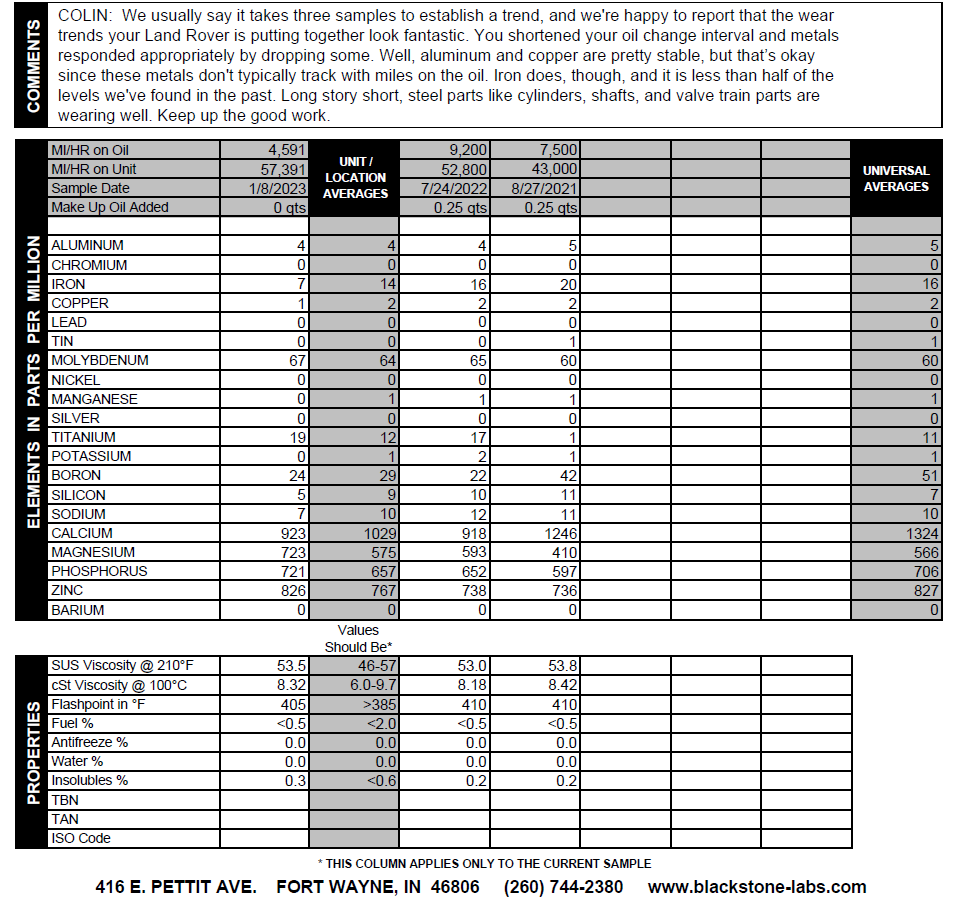

on my third oil change, still looking good according to Blackstone
gsxr
May 8, 2017
783
383
Big Sky Country
@callin , check out some other UOA's in the thread linked below. My latest is in post #46.

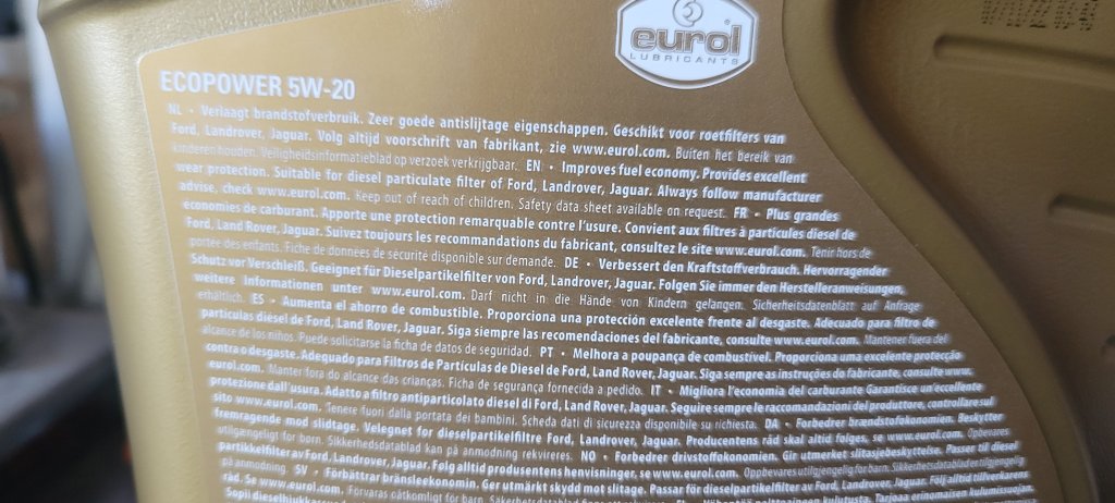

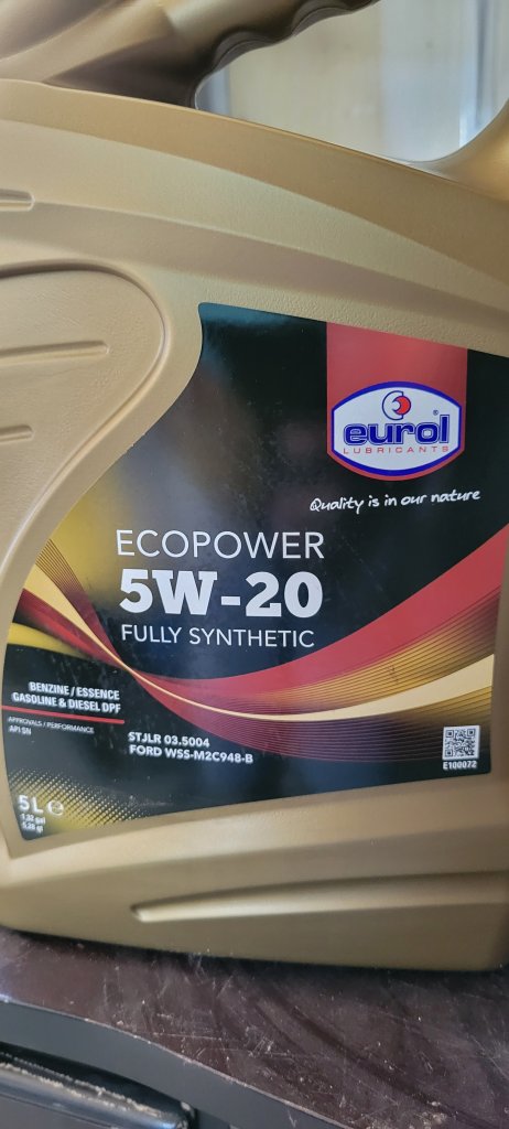

Hi All,
I found a distributor that carries Eurol 5W-20 that meets STJLR 03.5004 specs, but don't see this oil mentioned anywhere in these threads. What's the general opinion on this oil for a 2013 LR4 (5.0 V8)?
1,412
Magic euro oil from a jurisdiction that hates hydrocarbons. Why not just Mobil EP high mileage 5W-20? Not fancy enough? :0
