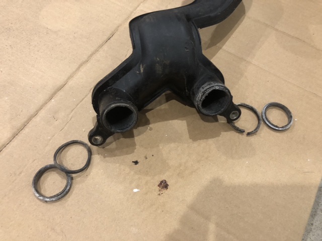

Thanks guys. Got it done tonight. Followed service manual far enough to lift front of intake for access. Removed throttle body from intake so it could more or less stay in position and the Coolant system could stay sealed. Once the intake was lifted, I pressured up the cooling system and confirmed leak was coming from base of the crossover tube. Upon removal, the o-rings and bottom part of the pipes that stick in the head, broke completely off and were stuck in the head. I’ll post a pic later. Doing it this way, I was able to pressure it up again with the new pipe in place and confirm it held pressure and wasn’t leaking from anywhere else.

Pic of my crossover pipe that came out had to pick the Orings and end of the pipes out of the block lol
