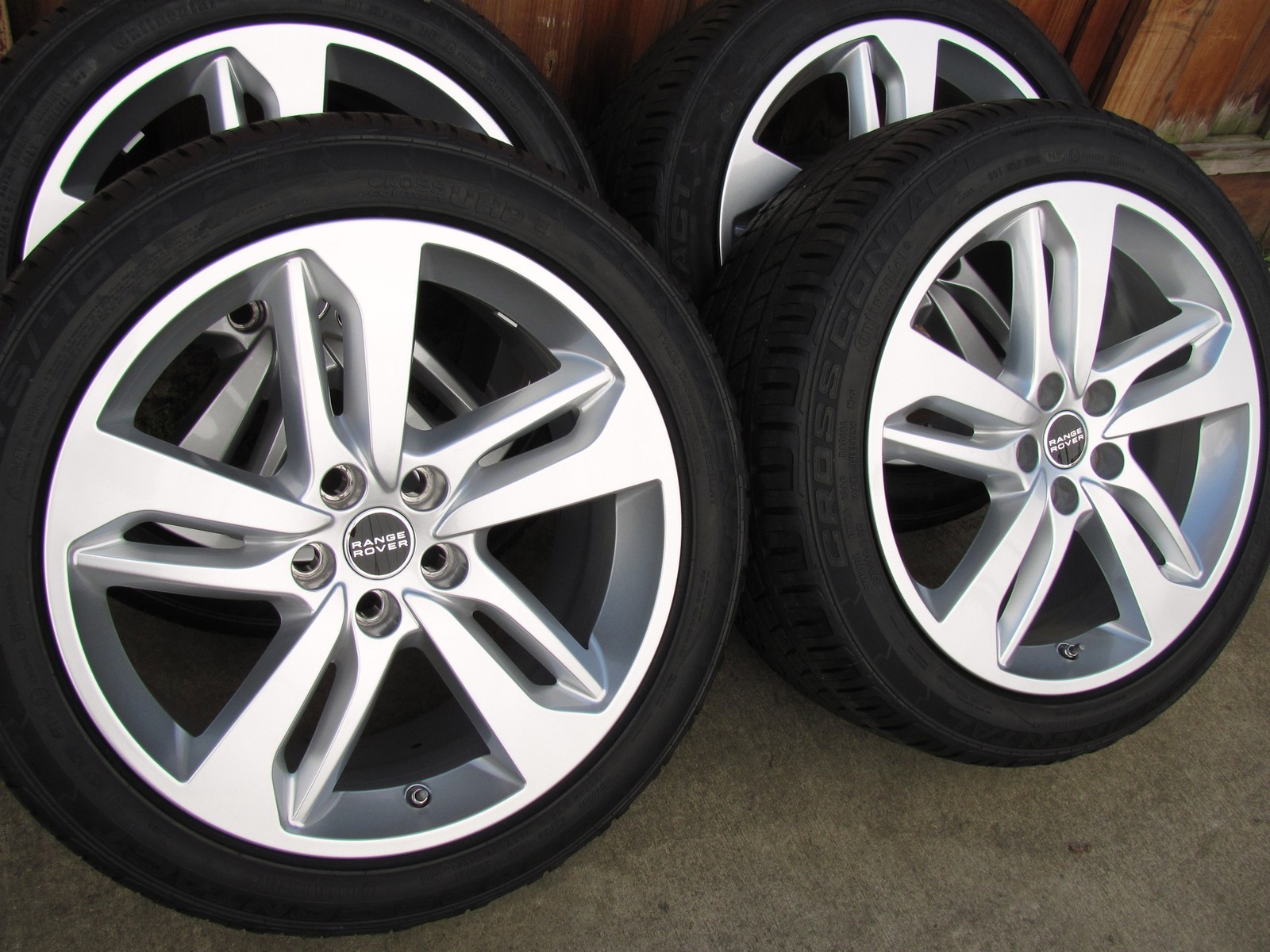

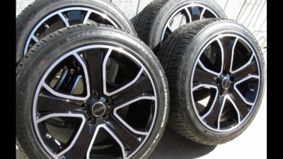

I have a black LR4 and want to change out the factory rims. Thinking of these Range Rover Sport rims. Does anybody know if they will fit? And any thoughts on the look? I will keep the stock rims for off-road.

As long as they fit the 255/55/R19 tires - you are set..... As umbertob said above, they share the same size 19" wheels and 20" wheels.
Those wheels will look nice!

While the bolt pattern and the hub diameter are the same, you might want check to see if the offsets are the same.

What's more important than anything is the wheel weight or load rating. Historically RRS wheels had lower rating requirements than the D3 or D4.

OEM wheels offsets are the same, weights (of both wheels and vehicles) are virtually the same, give or take a few pounds. Only wheels differences between the two models - other than looks - are stock tire sizes. RRS uses marginally lower profile tires than D3/D4 on the same size wheels, which may account for nominal load rating differences printed on the sidewall. For example, the standard size 19" tire on LR4s is 255/55R19 111V, the Sport uses 255/50R19 107Y... When it comes to the alloys however, fitting problems only exist with the Supercharged RRS, which mounts larger front brakes than both LR4 and non blown RRS: Some wheels that fit the LR4 may not fit that trim as a result, because of the larger discs and calipers. But any factory wheel off a 2010+ RRS should be 100% compatible with the LR4.

Don't much care for the silver set above personally, I prefer the... "Third *****'s Knights Cross" themed wheels in your first post, they look good on the Sport and I am sure on a black (or white) LR4 as well.

I like the black ones.

I like the black ones much better! I don't like the silver ones. Too fancy.
