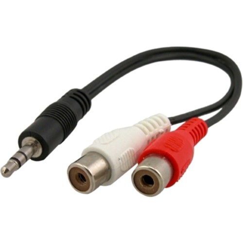

In that case, buy one of these adapters:
Plug the adapter into the female 3.5mm AUX port just to the right of the 3 RCA inputs, and connect the L/R male RCA audio cables coming from the iPhone to it. Set your head unit to "My Music - AUX" input and you should have video routed to the rear monitors for your kids, and audio playing through the car's speakers.
