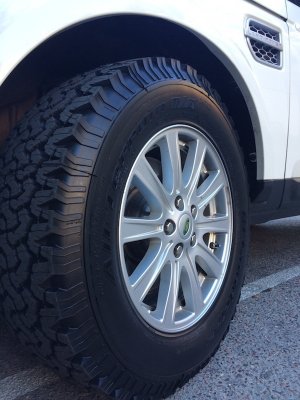

BFGs...Check!
2010 LR4
30mm Spacers
18" LR3 Wheels
265/65 18
