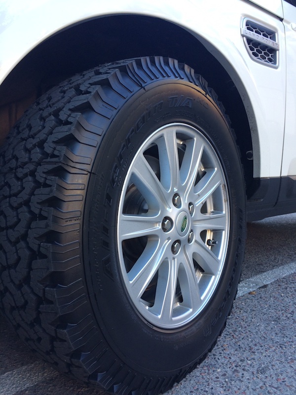

Nice setup.
Do you have any issues with the brake calipers (front)?
Do the tires touch the frame horns?
Mine do and I had to grind the calipers a little even though I used the slightly wider spacers...

Thanks!
No issues with wheel fitment that I know of...dealer installed and said nothing. That's something they would have mentioned.
Tires do kiss the frame horns. Considering J Rod solution, but not sold on it yet. Once the touch points in the steering are known, it doesn't really bother me much.

Tire size seems to have an acceptable variance. For sure the BFG 265/65 18 is slightly bigger then others rated the same size, so no doubt yours my have the same deal.
