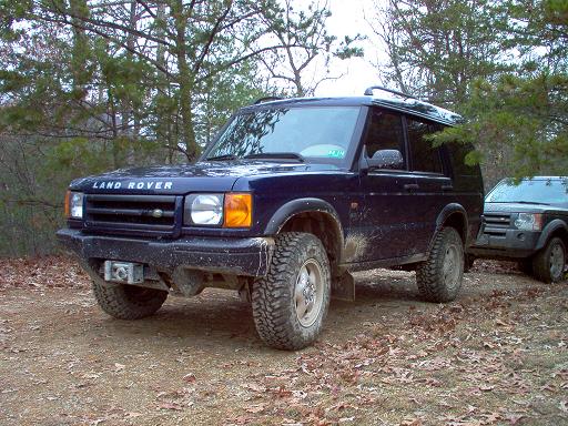

If you don't want to spend alot or want a full winch bumper, I got a Hidden/Discreet Winch Mount from www.DAP-inc.com for about $125, so I can use a regular bumper. You just cut/modify the bumper to access the winch. But i really like it since it's my daily driver, I didn't want a heavy steel winch bumper on it. You can see it on my gallery pics on here, or there's a few pics of it on my MySpace page. But mine is a DiscoII, but that mount will fit a DiscoI also. Just another option.

Cutting the Front Bumper to fit is a pain, cause no template is given with the Winch Mount. Just have to trim a little bit at a time till you get it right. Here is one link from a guy that did it, but the pics are small.
http://s99930825.onlinehome.us/site/index.php?option=com_content&task=view&id=25&Itemid=35
If you plan on doing the same to yours, I can take better/closer pics of mine and post them, along with some measurements that may be helpful. Attached is a pic on my DiscoII to give u an idea of what it looks like.

I have the regular steel cable on mine. But I don't see having a synthetic line to be a problem, would just need to get a Hawse Fairlead instead of a Roller Fairlead like I have on mine. I don't see why a Hawse Fairlead would not fit to the Discreet Winch Mount. The Roller Fairlead came with my winch, so that's what I installed on mine.
