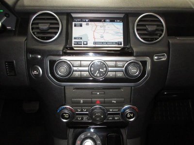

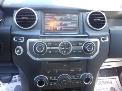

    Someone correct me if I'm wrong, but if you have the heated windshield, don't you have both F and R defrost buttons, (with wires through the F) around the edge of the climate control - instead of a big button labeled "DEFROST" ?
    Car without climate package:
    Car WITH climate package:

    This^ What is the top right button? If you had a heated windshield, you should have the button.
