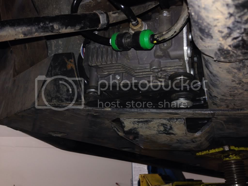

UPDATE - Fixed!
Here's the photo of the new bracket under the sliders. The left back corner of the bracket is barely touching the slider, but the compressor mounting bolt is also touching on that side. That's what is causing the noise.

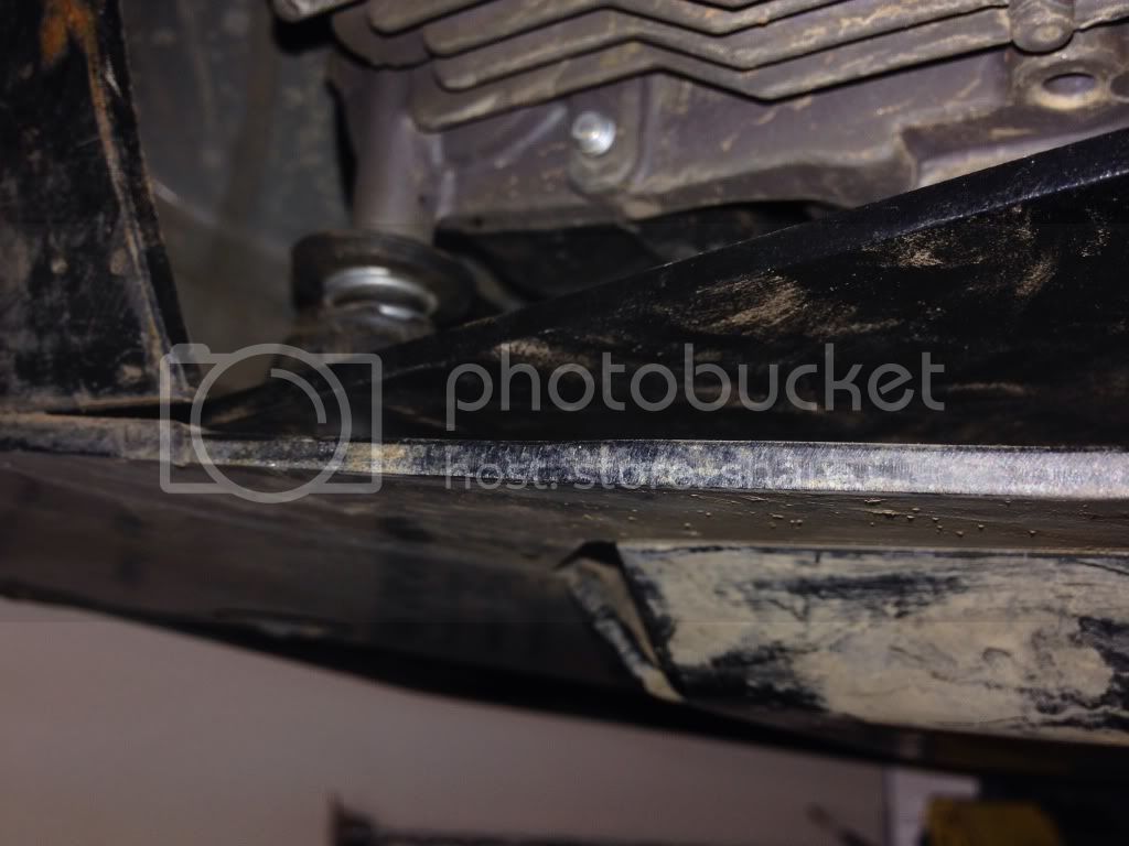

Another close-up of where the bolt is touching the slider.

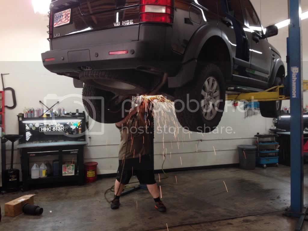

So, here goes!

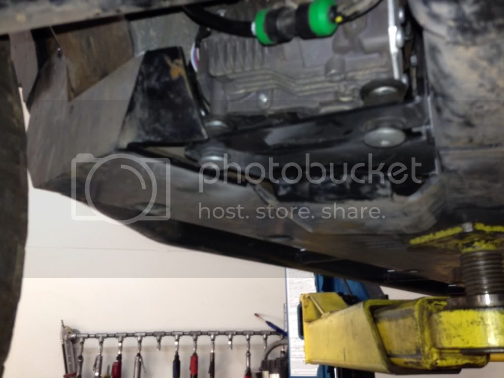

After (sorry about the photo quality). Now the compressor mounting bolt on the back left is not impeded. The original drop-down portion of the slider and the outside are still in place, so very little chance of hitting the bracket, even though it is slightly more exposed now.
