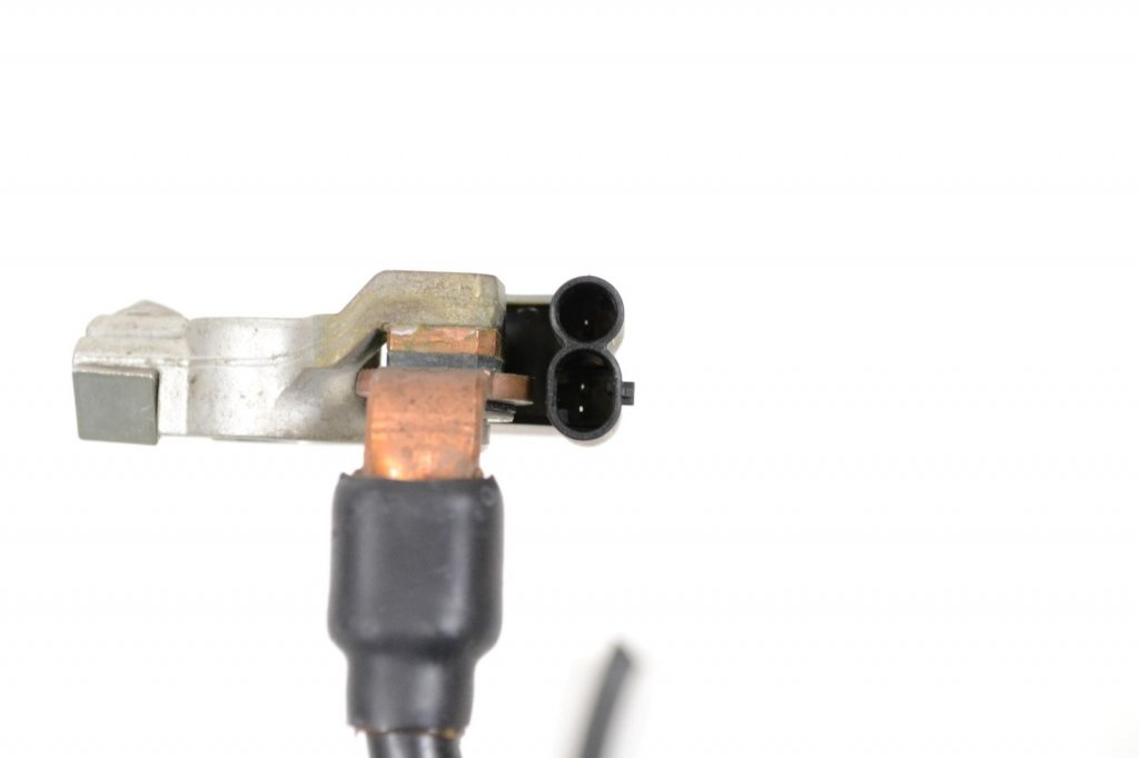

Do you ever check whether the battery is actually fully charged in the first place, the modern smart charging system has a habit of only partially charging the battery then relying on energy regeneration to complete the job. If there is little regen the battery can remain partially charged for lengthy periods, this is bad for the battery and may be the cause of a low battery warning which some owners are experiencing. Put one of these Ebay devices in the cig socket and check charge rate, if it goes into the 12 volts area alternator is not charging. If the starter battery has a sensor connected to the neg clamp it has smart charging. If it has that sensor just disconnect it then check charging voltage, you will get a battery warning but if charging voltage is within 13.8 to 14.4 volts it`s OK.
