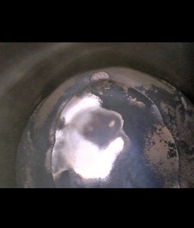

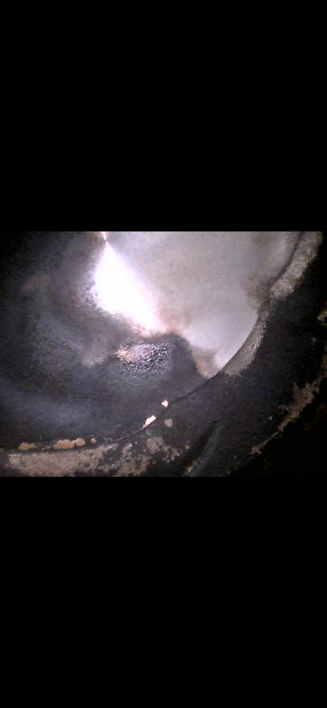

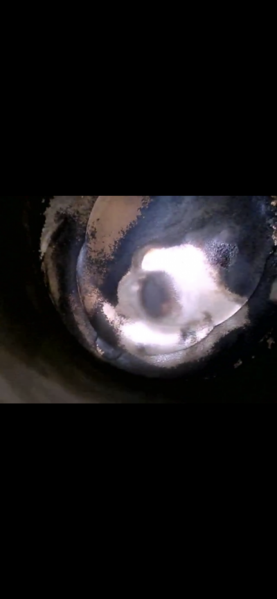

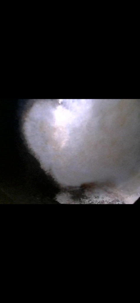

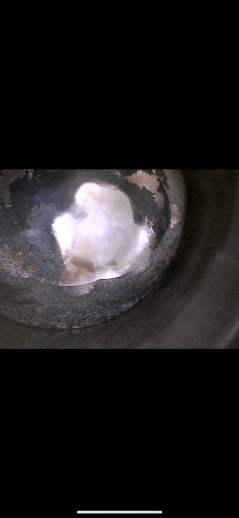

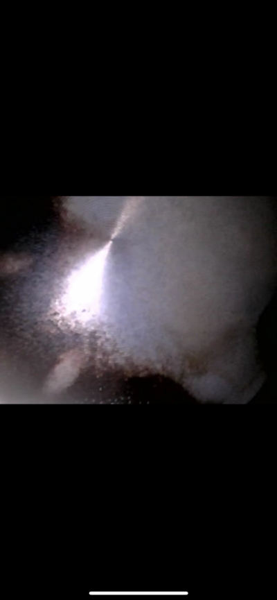

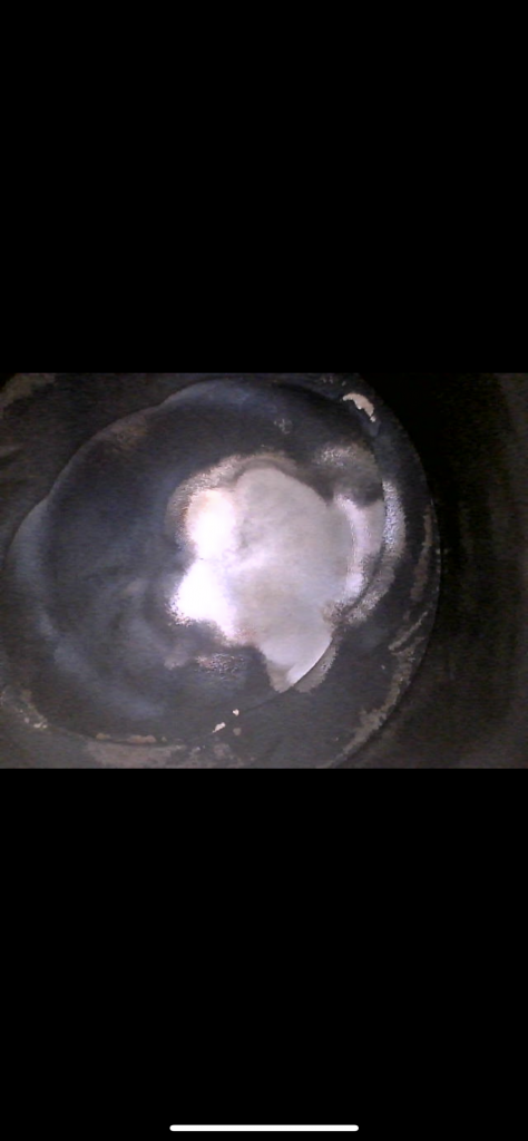

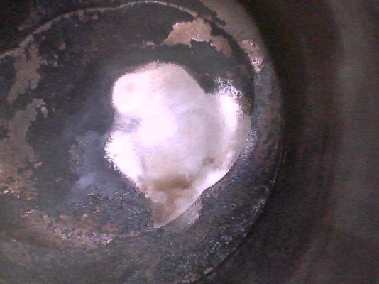

I’m back now that I finally have more free time so I decided to finally jump on this myself. Decided to use a borescope and pull the plugs just to be sure that I don’t have leaky injectors. My question, is this a normal carbon buildup pattern for a car with 143,600 miles? The center of all of my pistons look clean, almost a little too clean…Also does anyone notice any moisture? Here’s the best photos I got.

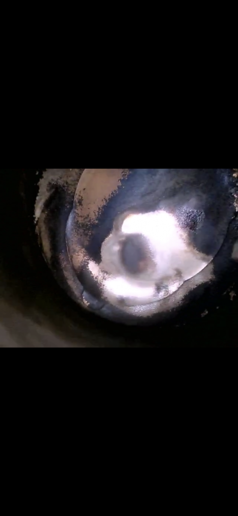

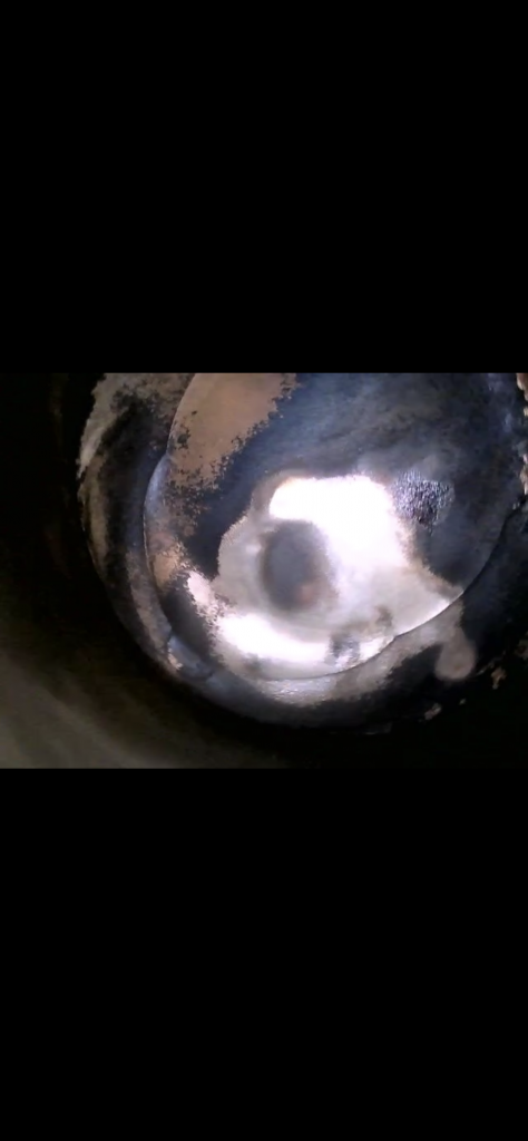

More photos

Wow crazy coincidence. I actually first started to notice the long start after a night time off roaring trip I went on where my engine temp was around 210 and trans temp was around 205ish. My volts on the IID tool were reading 11.9 with my light bar high beams and fog lights on yet when I turned them all off it didn’t increase. In fact, it barely increased above 12.4 and I could see my battery’s estimated state of charge dropping via IID tool. Also noticed in the cold, 45°f and below cold start, my voltage would hang low until I got on it then it would rise a bit. All weird to me. Now I know that this reading isn’t directly from the alternator or the battery itself but it’s odd that we both have issues with starting the car and voltage going weird.
Just to ask what battery is your RRS running?
Random but could be a key to see if ours has the same issue, when your in the middle of a long crank and you stop cranking does it sound like the car almost starts running for a second. Almost makes me think that the coils start firing as soon as voltage is freed from the starter cranking.
I was about to post a form asking how to diagnose the low pressure fuel pump check valve to see if my gas was actually receding into the tank after the car runs. However this is making me think it’s more electrical related
Edit: so your saying the car isn’t getting spark? This would line up with the fact that it seems like fuel is being sprayed on my pistons which is causing that big clean spot
