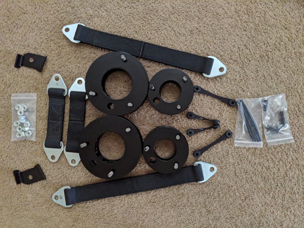

Got the missing package today, dropping the truck off Friday. Stay tuned
CaliDisco
Apr 17, 2018
78
25
Los Angeles
Looks great,
Did you go with 1 inch spacers or larger?
Did your spare fit below?
And we’re you able to reuse the tire pressure monitor sensors?
Thanks
