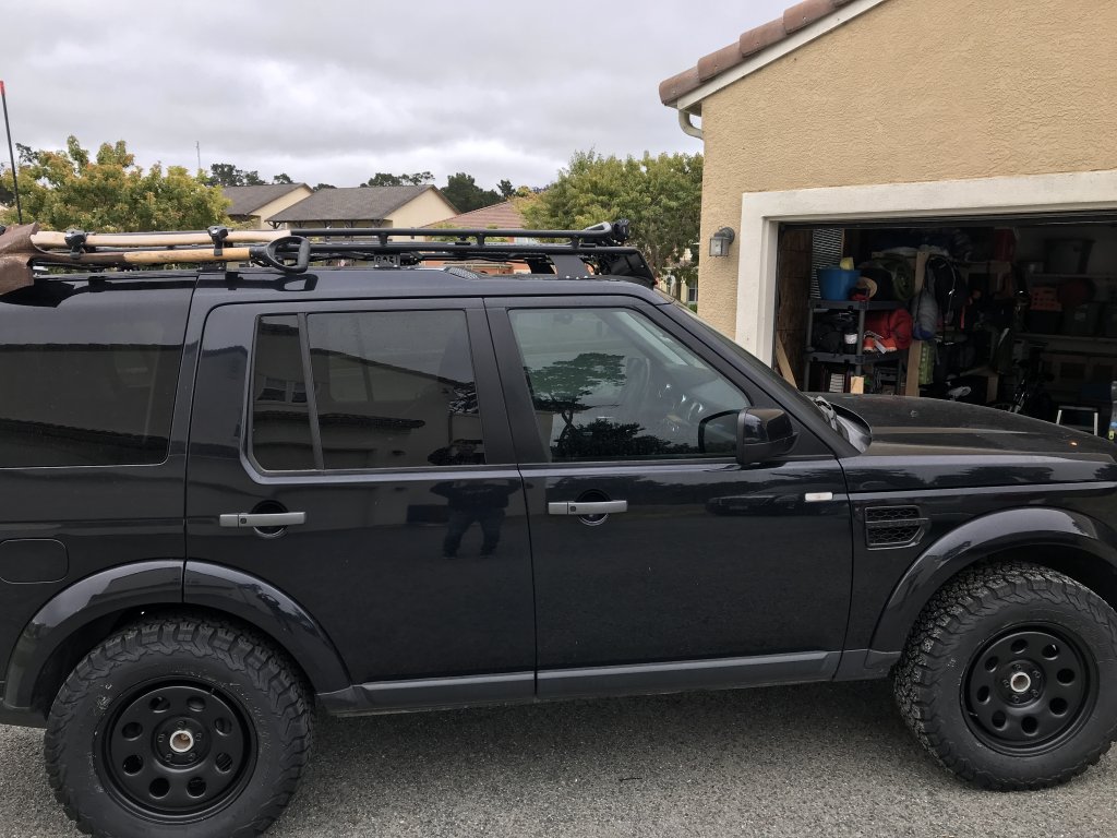

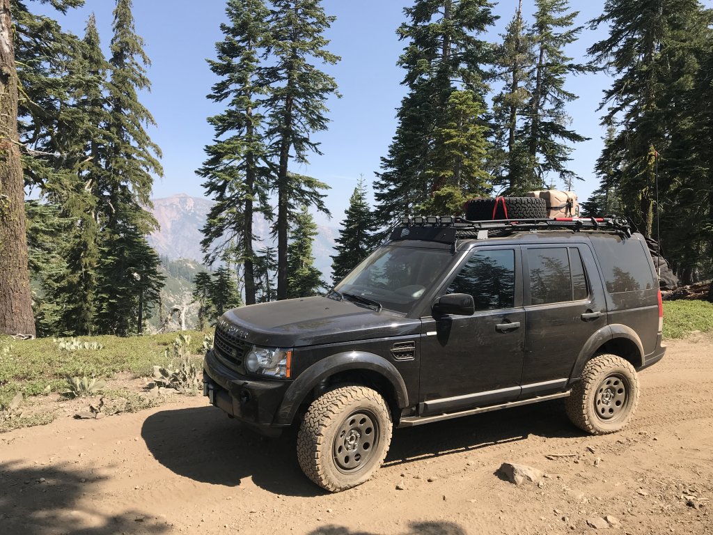

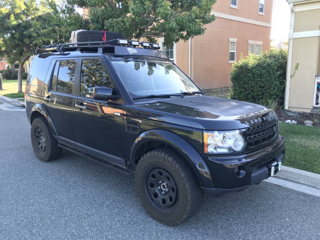

James, these wheels should have been my first mod, that's how much I like them. It's a noticeable difference on the trails having the extra sidewall when aired down, the ride is smoother and I'm not as worried about slicing the sidewall, which I did when slightly airing down 19". Also, so many more aggressive tire options for 18s as opposed to the 19s. I like the way they look and would absolutely recommend these wheels. I drove up a rock garden off road trail a few weeks ago and thought for sure I would slice a sidewall or damage the wheels, but the KO2s were just scuffed and the wheels just fine. The wheels have about 10k miles on them and I have no complaints whatsoever. I did purchase the spacers, along with lift rods due to the bigger tires.
I went with the BFG KO2 275/65r18. I had to cut, but I've heard some say with 265/65r18 you don't need to, or at least cutting is minimal. I cut and I'd do it again in a heartbeat! IMG_2265.JPG
