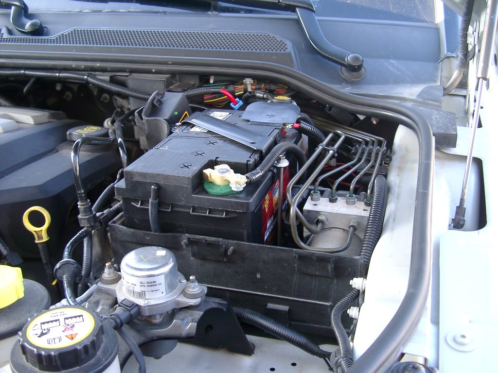

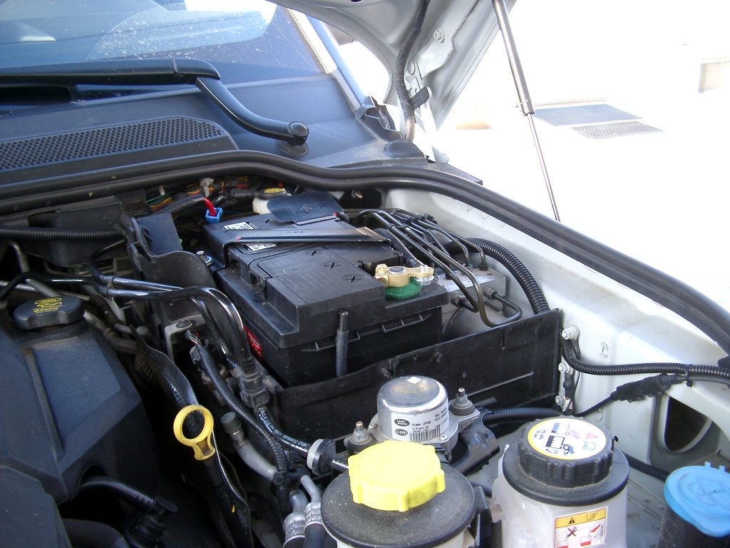

I have been using the CTEK US3300 retainer for probably the past ten years or so.
It is the 3.3 amp model that charges at 14.4 VDC for summer and 14.7 VDC in winter mode.
My 3 is a daily driver so about for a week of nights every three months or so, I will connect it to bring my Interstate batteries back up to near full charge.
For whatever reason, it does not matter how much you drive, the 3's charging system is not capable of getting the batterys much past an 80% state of charge. I do not know if the 4's are much different, but I doubt it.
I say batterys as per below, I have the Traxide dual battery system installed.
The CTEK US3300 user manual is also attached.

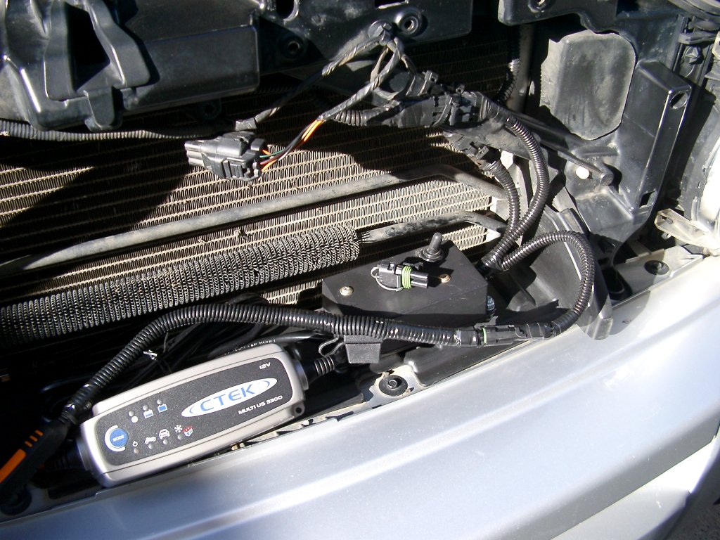

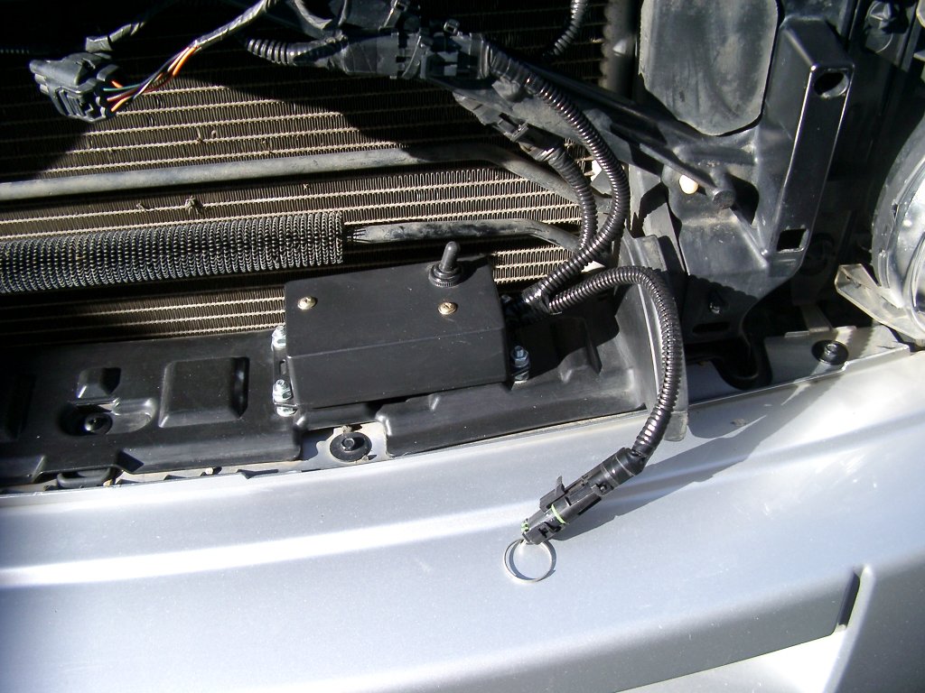

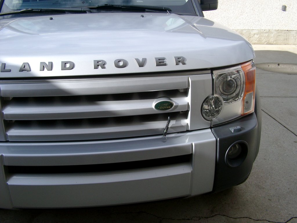

My post #12 above makes reference to the CTEK Multi US 3300 charger that I use. The jpg with the CTEK is just resting on the bumper is for information - the hood stays closed when I charge and the CTEK remains on a shelf. The electrical plugs are the GM Delphi Weather Pack type and the one resting on the switch box is to plug into the switch box pigtail when not in use to keep pigtail connector internals clean.
Below are jpg's of the switching hookup off the two batteries. The switch box is just that, a Double Pole, Double Throw, Centre Off toggle switch for transferring charging from one battery to the other or neither.
I switch both the ground and the positive - probably not necessary re the ground, but ....
The pigtail tucks up inside the grill when not in use and I can toggle the switch with my fingers thru the grill, hence the hood never opens in normal use of the maintainer.
I have ten amp fuses in the leads between the positive post of each battery and the toggle switch. The CTEK is good for a maximum of three amps - the fuse rating is just to protect from some sort of short.
I do the maintenance charge thing for about a month of nights twice a year, fall and spring. I have a garage that I park the 3 in.
My 3 is a daily driver - gets maybe 50 miles a day perhaps three times a week and 30 miles a day the rest. In spite of that, the charge system never really fully charges the batteries, hence the advisability of a routine top up at least twice a year.
My Interstate batteries last about six years - always die off warranty.
