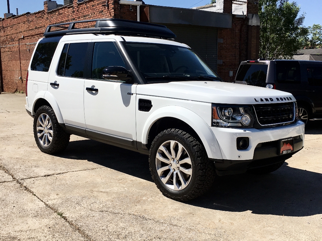

Notice the difference between the 285 front and 255 rear:

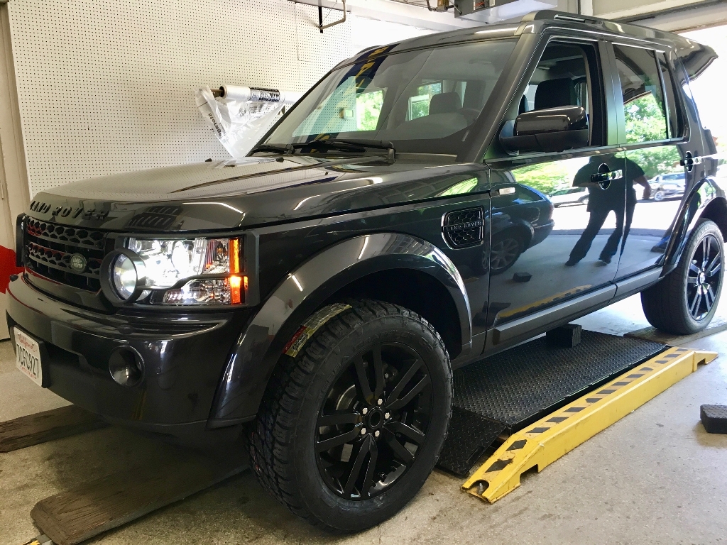

I'm on 275/55 with rods and a VERY faint rubbing at near full lock. Haven't decided if it's even worth trimming at this point.
I have a 2012 LR4 with BFG KO2 275/55 r20 on it and experience significant rubbing, even with a 1.5in lift. I am thinking of trying the 285/50 to see if that changes anything
